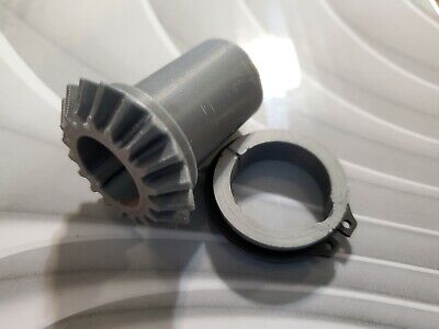

Took a little look around this evening and found this on ebay.
Interesting to read his comments in the description.
I think it is the same $44.00 one Torontobuilder mentioned.
I also took a look around for the actual blueprints for the 341-051 gear. Those would give you all the dimensions to easily draw it up in a CAD program and then create your own STL file. No joy...yet.
I'm in Calgary, but if you do find the STL for it, I would print it up and send (maybe not....lol...Canada Post strike) it out to you.
From reading the original was made from Zamak and the ABS would be more than strong enough to replace it.
Cheers, P

Taking a look at that ebay ad I noted the shaft of the gear rides in a fitting.
A fix for your gear might be to drill it and add a few brass pins along the shaft of the gear that is inside the fitting. The pins would be held between the lead screw groove and the outer fitting.
