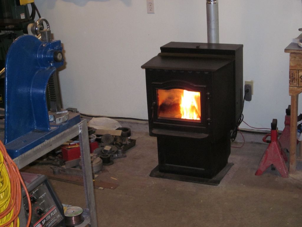

I live in a very damp high humidity area. I have a pellet stove in my shop. The stove operates off a wall thermostat.
I keep it set to 5 degrees most of the time turning it up to 15 degrees when I am out there. If the outside temperature drops below -20 I will leave a 1500 watt electric cube heater running on low. Twenty plus years and I have no rust problems at all with any of my tools or machines.
Not familiar with pellet stoves at all. Are they expensive? Don't you have to manually keep feeding them pellets? Do you have to worry about CO2 or CO poisoning?

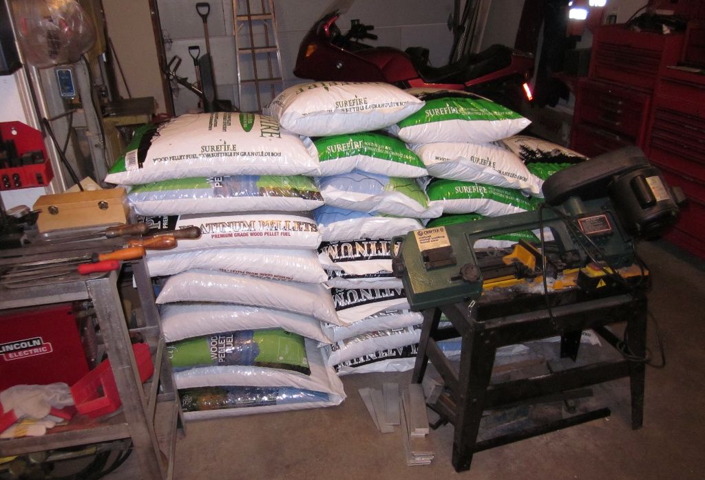

Pellet stoves are safe as long as they and the chimney are in good condition. The chimney is insulated and galvanized outside and stainless inside. The stove holds a 40lb bag of pellets and that will heat the shop with me working out there in the evenings for three or four days when its -10 out.
The stove:
30 bags of pellets at $6.99 a bag, three months worth depending how cold it gets. I buy pellets by the bag, if you buy them by the ton 50 bags there is a cost saving.
