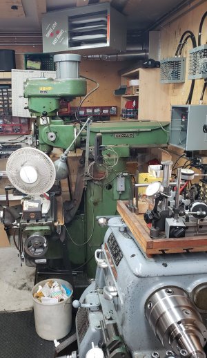

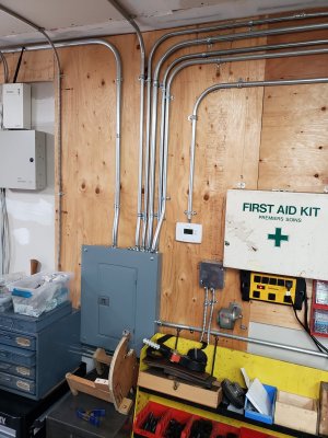

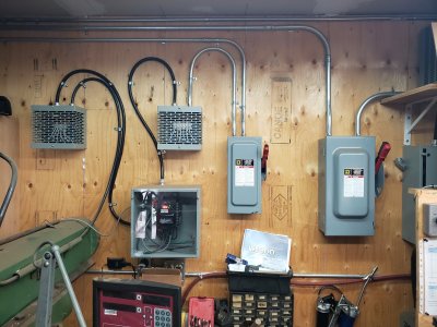

My garage was 2x4 wall construction. I screwed 2x2's onto them, installed R22 insulation, vapor barrier, then 3/4" t&g plywood all around. Ceiling was vapor barrier, 5/8" drywall, and several feet of insulation! I then mounted all the electrical right onto the plywood.
I originally used a 220v heater for the 1st year. Electric bill was not good. The following year installed gas ceiling heater. Huge difference. I use a dehumidifier in the summer which works quite well, unless it gets really hot for a couple days in a row.
