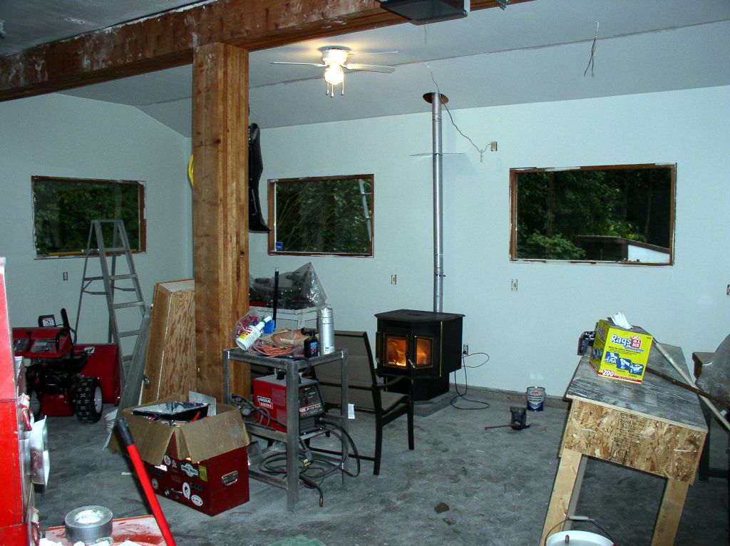

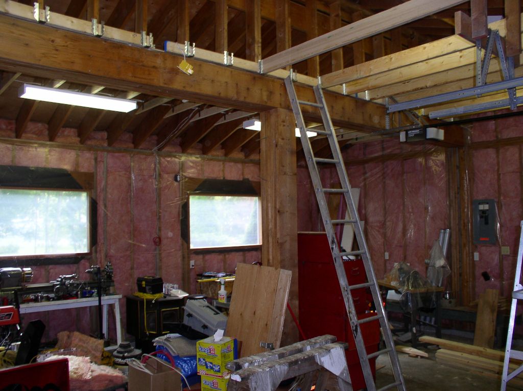

I have a 40 Mbtu radiant heater tucked up in the corner of my 8-ft ceiling wall somewhat similar to these internet pictures. Unless I wanted to use that corridor space for skinny storage, it really is dead space utility wise. So a great space for a heater IMO. My drill press & scroll saw are pretty close distance wise, maybe 6 feet diagonally. I don't really notice any temperature discomfort (kidding with the picture). My lathe & mill are on the opposite side of shop & its maybe a degree cooler. Everything with mass absorbs the heat. Overall I'm very happy with the unit. +20 years.
