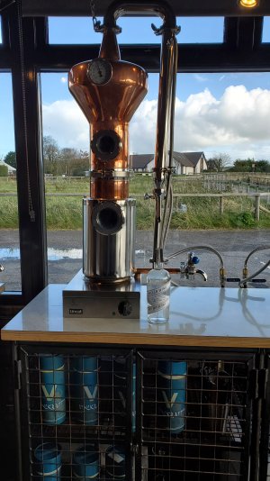

We did distill some Gin almost two years ago but that was at a distillery in Wales. They even put a custom label on our bottle so we could take it home through customs.

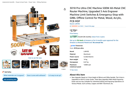

And off on a slight tangent, why does Amazon not need to comply with consumer protection laws? Bought a new-ish CNC router, advertised as having a 48 VDC 500W spindle motor. Spindle motor is 2" diameter x 4-1/2" long. No frickin' way this motor could survive 500W input. So I set it up with a couple of meters and measured current and voltage at no load. Power supply is 48 VDC, rated 11 Amp. No load draw is 0.6 A @ 47.6 VDC. If I heavily load the motor, current rises to about 1 A.
If this motor is capable of 500W output, I'm about to be chosen as the next Pope.
Although, to be fair, the mechanical aspects of this CNC router are actually quite robust. And I got it at a deal, $200 because the controller card is toast. Replaced it with a GRBL card from stock.

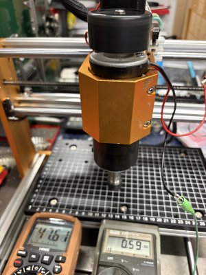

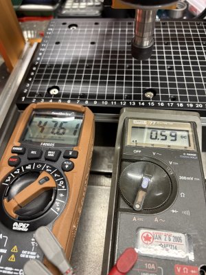

No load draw is 0.6 A @ 47.6 VDC. If I heavily load the motor, current rises to about 1 A. If this motor is capable of 500W output, I'm about to be chosen as the next Pope.
(Not a motor guy but willing to learn LOL).
I'm not clear what you mean. 28 watts just to spin the motor = 5% of sticker output, that value by itself means it could never reach 500W somewhere on the torque/rpm curve?

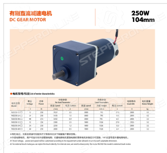

More likely the Amazon values are just utter fabrication. Comparing the Amazon motor to a reputable distributor, Stepper Online sells a 250w 48VDC brushed motor. The S/O 250W motor is twice the diameter, 1.5x the length, and shows 0.9A no load at 48VDC, to a maximum of 6.5A at 90% of no-load RPM. So <maybe> the Amazon motor could get to 500W, but I suspect it would go up in smoke long before it got anywhere near the published value. I did load the motor far beyond what I would expect to see in operation, and it got to a peak of 1A current draw at 48VDC, so about 50 W.

OK but (my understanding) a no load test is telling you watts consumed just to turn over = cumulative energy lost to internal friction, winding/magnet efficiency etc. right? The shaft cannot turn anything at this zero torque vs rpm coordinate? So if those watts (you measure volts & amps) equates to 5% of rated power and (big if) remains relatively constant, wouldnt that just de-rate the sticker max watts by that amount? So just assuming it was 550W nominal on the sticker, 100-5 = 95% * 550 = 522 watts at some torque/rpm combination? Maybe I'm off base.
The spec chart you shows no load rpm vs load rpm at various voltage & torque combinations. To me these are 'along the curve' data points. But look at calculation below, now I'm more confused
no load 12v * 3.5a = 42 watts 42W/250W = 17% gives 3550 rpm
at load 12v * 27a = 324 watts ... but the motor is rated 250 watts? what gives?
Generally motor size is correlated closer with torque output than power output, because you can get more power simply by spinning faster. Comparing the power of a much slower motor is kind of an apples to oranges comparison. Kinda like a 200hp literbike engine vs a 200hp industrial diesel.

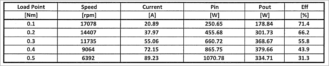

This smaller motor has a peak mechanical output of ~380w but draws ~800w of electricity to achieve it (the 420w in between those numbers becomes heat), at 10,000RPM. See datasheet here. I'm familiar with this motor and trust these numbers.
If you were to dyno that spindle, I suspect there's somewhere where it's at least drawing 500w.

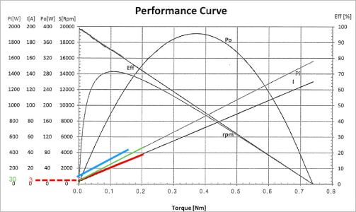

Now this datasheet makes sense to me. I assume Pin (power in) is volts * amps = watts. Pout (Power out) also converted to watts, is actual at the shaft or 'brake'? Each load point combination of parameters is an X,Y point coordinate on the chart, X=Torque, Y=whatever. This makes the curves or lines depending on the parameter. Pin is always greater than Pout. The ratio between is efficiciency. Am I getting it so far?
So maybe this explains potential confusion of random motor with no chart but a single power value 550W. Is it maximum torque at 20% efficiency an a few degrees from melting? Is it at maximum efficiency? Is it Pin or Pout? Technically they may not even be lying, but without more information or actual brake test we dont have a clue.
and they referernce free load as a line item, expressed as amps & rpm
Carrying on, maybe I'm on a roll. The no-load value are the Y coordinates at X = Torque = 0. So 3A (green) looks right. Or about 30 watts Pin. Its consuming power without the shaft doing any work.
Not exactly sure if that is measured directly or extrapolated but what I was trying to say a few posts up is knowing this value alone, we dont really know what the motor is capable of; the curves extending to the right. Say I had a cheaper motor (blue line). My gap is higher, its for sure less efficient but where does it extend from there?
Am I on the right track?
Yep. Everything is good so far (at least for a brushed DC motor like the ones we're discussing). You'll also notice on the right side mechanical power (and efficiency) drops to zero because RPM drops to zero. It's not doing any work because it isn't moving, but the motor is drawing it's maximum electrical power and delivering it's max torque. Peak mechanical power is in the middle - at half free speed and half stall torque.
You can make a reasonably accurate graph if you have the free speed (RPM), free current (A), Torque at a given RPM (N-m), and current at that same RPM (A). You can choose 0 RPM for these values too (stall torque/current), but be careful because stalling motors like the one I posted turns them into single use smoke machines.
An easy way to estimate stall current pretty accurately is to disconnect the motor and measure the resistance across the motor leads. I=V/R so you just divide the supply voltage by your measured resistance to get your current estimate.
You can estimate stall torque using a calculated torque constant, but real life torque tends to vary. Unsurprisingly, a real dyno is the best way to evaluate a motor.
