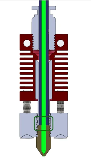

I don't have experience with Nylon, but just a quick comment on temperature. When I was hunting around for a printer 3 or so years ago I distinctly remember warnings about if your extruder has a PTFE liner, it will start off-gassing neurotoxins temps above 250C LOL.
Agreed you don't want hot PTFE.....but afaik I the PTFE is on the other side of heat break and should never see temps like that. As for outgassing and risks with filaments....yeah, we should probably be more concerned than most are. Enclosure with a carbon filter would be best.
I hope this is true for all printers currently on the market, but the ender 3 atleast (not sure about the ender 3 v2 or ender 3 Pro) had the PTFE tube go all the way through the heat break and butt up against the nozzle.

some printers have an all metal hot end, anything with an e3d v6 for example, but most have a ptfe lined hot end for ease of use and reliability (less prone to jams/clogs)
in either case, swapping to an all metal hot end is pretty easy, depending on your hot end you may even just be able to swap the heat break for an all metal version
I changed my Ender 3 hotend to a all metal Microswiss. The ptfe stops before the extruder gears so not much heat there. Haven't printed much with ABS or NYlon but wnated to have the option.
Wow, that is not good! I have a prusa which has an ED3 hotend (actually theirs is a a slightly modified ED3 hotend, lots of problems until I made it a true ED3) and the PTEF terminates on the cool side of the heat break

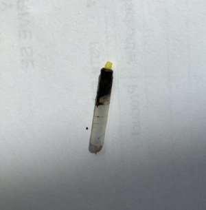

My extruder has been sketchy for a couple of years with areas where it was clearly under extruding. This week it got so bad my prints failed. The attached picture shows the ptfe tube. I print ABS at 230C. The ptfe is likely about 10 years old and has shrunk to the point cold filament won’t go through it. Even heated up with the nozzle removed it was difficult to push filament through.

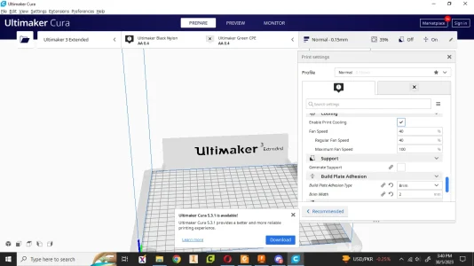

First off, I have had great success with PLA so far. Only one messed up print out of about 150 pieces because I didn't have the bed leveled quite right.
however, I warned you I'd be a pain the butt with questions so here goes.
I purchased a roll of nylon filament and wanted to print a couple things and have had nothing but failure and frustration. I have spent several hours on google and youtube trying to figure this out with no success. I cannot get the prints to adhere to the bed, and have had to unplug and clean out the nozzle several times (glad I have an extra one)
Here's what I've tried so far:
-gone through all the slicer settings (I'm using Cura 4.5) and tried many different combinations of temperature and fan settings as per several suggestions on the 'net
-installed a glass bed with glue stick and retried the different settings.
If anyone has suggestions that could help me sort this and figure out what I'm missing would be awesome.
BTW...It was a brand new sealed package so I don't think I need to "bake" it and dry it out, or do I?

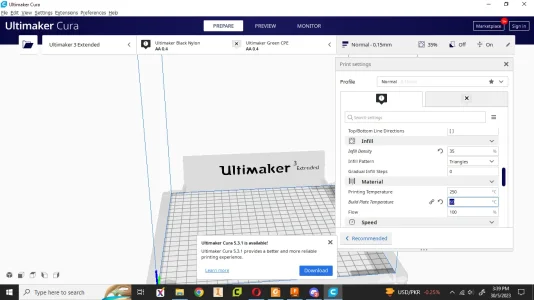

we have success with our ultimaker printers and nylon, what settings are you using to print?
also what size filament are u running?
we run with glue stick on the bed
glass bed
250C nozzle temp
255C for first layer
60C bed temp
thermal settings
also print cooling and 2-5mm brim helps to keep it on the bed
