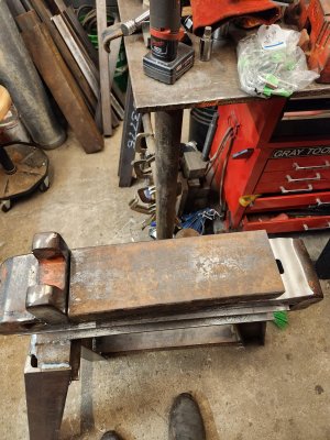

Here she is, all welded up.

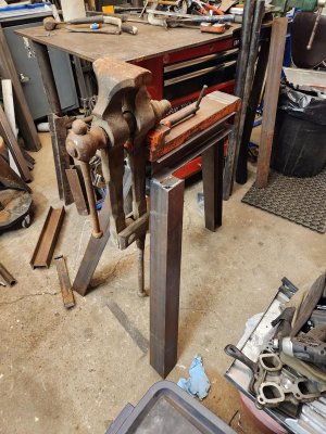

Grew another arm and tossed the anvil on, and clamped the vise into it.
Vise is still sitting about an inch too low, but it was too tricky to try and hold it up and in there and tighten the clamp but you get the idea. Pretty happy how this came together. Still a bunch more work to do, but a few steps closer anyway.
Didn't feel like I accomplished much today, but I kicked the can a bit further down the road.

Then it was time to weld it on, and add a cross brace. I still need to add some to tie in the front legs. Will have to cut/scribe those to fit the old fashioned way. No fancy cad templates this time.
A trial fit with the vise in there. I was aiming for 42" and still have to weld some 3/8" plates on the feet.
And here it is with the vise bolted in. Even without the fork plate welded on it's pretty solid to hammer on, and pretty stable too. I think this will be a pretty handy addition some light forging and detail punch and chisel work. It's not going to be used for heavy forging.

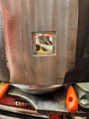

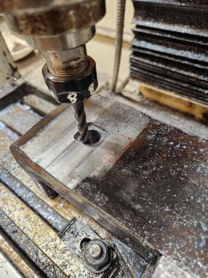

I'll probably just fire the Tormach up and mill the hole tonight. I wanted to do it manually, but I want to swap vises even less.....I really just want this done and out of the shop by tomorrow afternoon so I can drag the next project in..... Not much left to do now.
Went out after dinner to try and work on the vise for a bit. Threw in the towel for today, and decided to just mill it in the Tormach. 1"x1"x1.53" deep hole with a 3/8" endmill of unknown history (used, not by me). Coolant pump not working again (it gums up if it sits too long), and I didn't want to piss around with it, so I grabbed the squirt bottle and air nozzle and was the Tormach's next best M8......
Surface finish OK, not the greatest. Picture actually makes it look worse on the screen.
You'll notice I moved it towards the end more, from where I initially drew it. I actually had a last minute idea that I can make a cradle for the swage blocks to sit in that sits in the hardy hole, so I moved it to 12" off the corner block I welded on earlier. We'll see if this idea pans out later.......Might be a stroke of genius or a flop.
Didn't have an em long enough to mill the inside welded corner either.......nor could I find that broaching bit.......I think it's at work actually. I can't wait to bring all my tools home from work and have them at home where I actually need them. With what I do now I could probably work out of a small top box that would fit in my car.
My filing arm should get a workout tomorrow.....
Wasn't too bad. Only took about 45 minutes start to finish.
