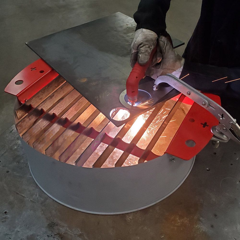

Plasma cutter for under $300!!
from 911 Motorsport?
No I made it - but 911 sells a pre-cut kit that you weld together. I copied their idea from pictures on their web site. I made enough modifications that I don’t think they will send blood thirsty lawyers looking for a 25% Trump tariff for copy rights infringement.
Which reminds me that I should have included a link. Even our one-eyed-hairy-farmer could stick it together:
I'm impressed at the compliment. But I doubt it. You forgot the shakes and the lack of experience.
On the other hand, if it can be bolted together......
This is my plasma cutting setup.
This is really cool Craig. Love all the thought you put into it and the functionality.
Never in my wildest dreams did I imagine there was anything other than water (or nothing) in that drum.
Spent some time looking for oven grills. All too small. Thinking maybe drilling and tapping 1x1/4 square bar is a possibility to make a square rack.
All of course assuming I keep the plasma torch.

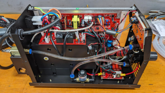

Thanks for bumping this thread, was about to go hunting for it. I finally unboxed the bestarc welder and opened it up (for youtube video, was filming this evening). Still haven't cut with it, but can at least share a pic of what is inside. It's less bad than I expected....not amazing, but for the price, better than I expected.
