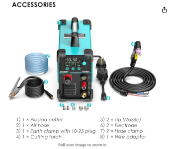

Maybe, but the Inlet filter already has a standard male airline quick change nipple on it......
They show it as an "Air hose" in the pictures on amazon:
That's just weird. There already is an air hose built into the big cable, and it looks stronger than that reinforced hose. There is a quick connect on the back of the unit too!
At this point, I think @Jswain is probably right. It could be a drain hose for the air filter.

Those posting the pictures of the hose that comes in the kit for the plasma cutter. Only thing I can think of why it is there is for the idea of replacement or connection. Like when you buy a drill or grinder from some of these sellers and they include a tube of grease and a set of brushes.
