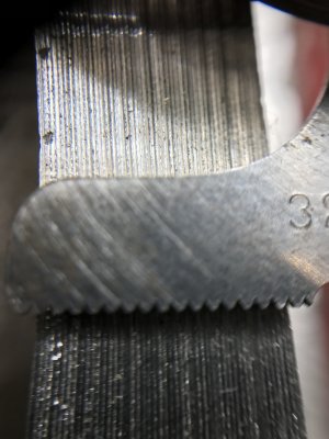

Each row of teeth will be offset from the previous row by the thread pitch divided by the number of flutes.
What I want to know is how he stops it from vibrating like crazy as each flute tries to climb its own cut!
No vibration. We have the gullets in the tap that separate the teeth. The length of the teeth is fairly short, so yes there is a small helix angle and there probably is a little binding during the cut, but I didn't have any issues. Look at a thread milling cutter, its like I have 6 of them cutting at the same time.
I see.
I missed two factors in my assessment.
There are 6 flute, not four. And it's a 1" Tap not a small 3/8 or 1/4.
Because of these two factors, there is very little actual advance along the thread per tooth. So not much to worry about in terms of pulling the tap along the thread Helix. I think a smaller tap would not be as forgiving.
Cool idea!
Hi Peter, the tap has not been modified. Its a little difficult for me to explain properly, but here goes. Think of making a thread on the lathe of 16tpi. So in one inch we've cut 16 threads. Now if we attach another tool post directly behind with another threading tool, and advance them at the same time, we're cutting another groove 180° to the first thread. So now in one inch we have 2x16 threads=32 threads, if you had 6 cutters starting to cut a shaft all equally placed around, then you have 6 x 16 threads=96 threads in one inch. Its the same idea as multi start threads. Did I make that more confusing?

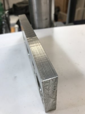

A chunk of 1/2" aluminum plate from my scrap bin, and a truly horrible and dull 4-flute 3/8'-24 UNF tap from a $12 Canadian Tire tap and die set. No coolant. No measuring and the plate isn't set true to the quill. No effort spent in trying to make it pretty, just chucked the tap into my mill (using a drill chuck), and scrubbed it across the plate a couple of times at 500 rpm, 0.010" depth of cut per pass. Lots of tearout, the tap wouldn't cut butter.
My ancient eyeballs and a 32 TPI thread gauge says 96 LPI is about right.
This could be an interesting surface finishing method.
Well done. You'll get a better effect in steel or high strength aluminum like 7075. Aluminium is generally gummy and won't work as nice.
