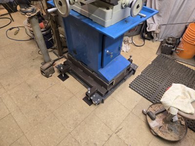

Mill base is done now it is rock solid, level and most importantly it sits at a comfortable working height.

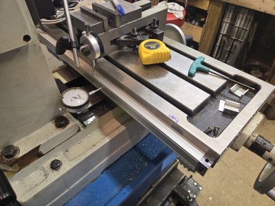

I have a dro question I am hoping someone can answer. I am slowly working away at installing the dro the Z axis is done and I am working on the X axis. This is where I have run into a snag. the scale has a .007" curve to it over 24". Or at least the aluminum extrusion housing the glass scale does. I have checked this with a dial indicator as well as a 24" straight edge and feeler gauges. Is this enough of a deviation to be concerned about? Basically the dial indicator is set at zero at one end and as I run the table down the indicator slowly drops to -.007" in the middle and then rises slowly back to zero at 24". I noticed when taking apart the scale to cut it down that the read head seems to be spring loaded and looks like it could handle a bit of deviation and still be held tight to the glass scale. Or is that just wishful thinking?

Can you share a picture of how the x axis scale is mounted?
Here is a pic of how it is mounted. The read head is not yet mounted since I am still trying to fin tune getting the scale into the right position. The direction that it is slightly bowing in is in and out not up and down. In other words I would need to put a shim in the middle between the table and the scale. I'm not super keen on doing that glass doesn't like to bend and the last thing I want is to break the glass scale inside.
What you can't see is that currently there is a .020" shim between the scale and the table at the far end. Sadly I don't really know if that is needed at all or if it is the right amount. Since the scale is effectively an arc then two points will always measure the same. Shimming the end out just changes where the to points are that measure the same on the indicator.
I haven't yet tested to see if it actually makes a difference on the display or the accuracy. I will do that one I have decided its exact location and mount the read head.
If I understand correctly, you have a scale that bows away from the table at one end by over .020” but bows in -.007” in the middle or thereabouts. Given that the near end of the scale in the picture is fixed and not shimmed how is the scale getting closer to the table in the area where it’s -.007?
He said earlier that it came that way from the factory.
I appreciate your concern. But 7 thou is nothing. You won't break it. Bottom line is that you can't fix that any other way without putting your read head onto a mechanism that moves it in and out to follow the scale. That's ridiculous. So you have to straighten out the scale.
