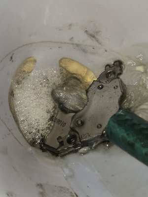

Ya I assumed a bicarbonate bath and good cleaning after regardless, acid causes rust too, no? I still want to try alka seltzer warm, but ultimately for everything here im using mostly wire wheel. I was thinking fancy for maybe the rusty reamers, but i just soaked that stuff in rust chek. Anyone run electrolysis in a bucket with a battery charger?

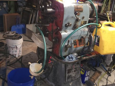

The flushings will continue until crew moral improves.

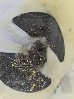

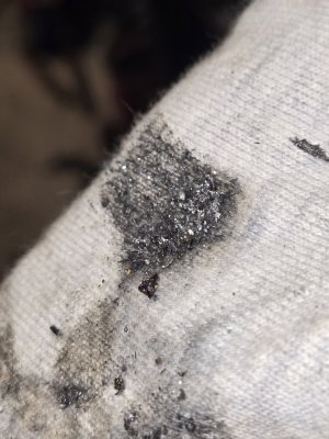

All I see are particles

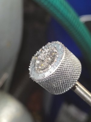

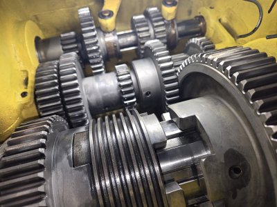

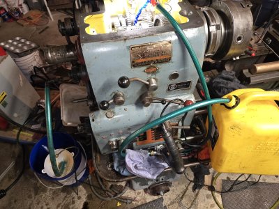

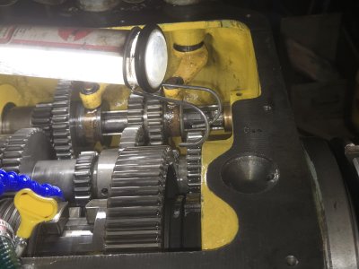

Five gallons of diesel flushed through several times. I touched the gear burrs various ways, theyre hard af. Magnet sweeping each time, fishing, flushing, running through 190 micron paint filter and magnets. Over and over. Ok Im not popping the spindle to debur the feed direction gear underneath, Ive done what I could.
Alright i get it to where i cant see or grab much sediment on the bottom, good enough.

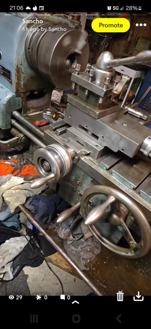

You did an awesome job on the clean up. the lathe already doubled in value.
Oh ya and the qcgb dumps its oil within an hour or so
.......on the plus side, you know that it's always fresh and clean. :rolleyes: .....just try and pretend it's a South Bend where you put in at the top and it runs out the bottom, almost like a Harley.

I figured that would clean up nicely, thanks for proving me right. :D
Congratulations, for reasonable money and some elbow grease you have a great addition to the shop. :cool:
