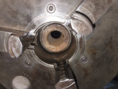

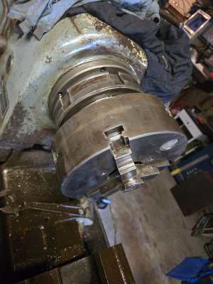

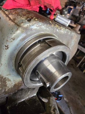

Rolled her inside today. I wondered if the L1 taper to the chuck was rusty so I popped the chuck, it wasn't at all. Did some cleaning in the area.
Then decided to clean the 3jaw. Got it loosened up, jaws out and cleaned up.
Shes nice and smooth now. Ultimately I intend to use the 4 jaw. The jaws are in better shape and I like dialing things in. Good enough for today.

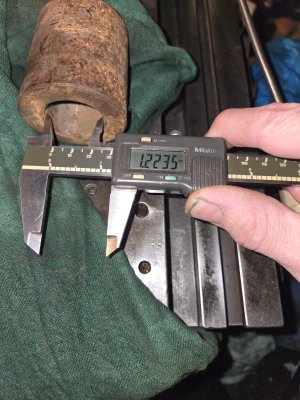

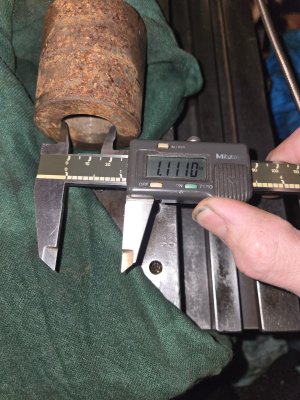

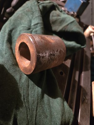

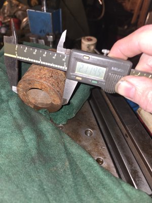

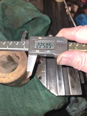

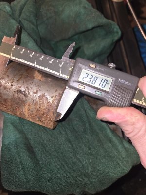

Thanks for posting your progress, I have been following along. I have been setting up mine as well, just adding a DRO. Is there any chance you machine came with the headstock taper adapter? Seems like it’s a special Colchester one and would be amazing to have the dimensions to make one. Thanks!
Hmm there was a piece in a box with an inside morse.... I didnt realize there was a taper on the outside or know what it was for but appears to be this taper adapter! Mystery solved, thanks.
Hopefully those give ya an idea, Id imagine you check the taper specs when making.
View attachment 53977View attachment 53978View attachment 53979View attachment 53980View attachment 53981View attachment 53982
Yep, Colchester did that. My chipmaster has a MT4.5 bore, but accepts a sleeve reducer to MT3.

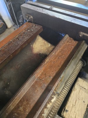

You can see a slight ridge on the main V there. 3.7 thou by fingernail. Actually Ive come up with a new product idea - fingernail calibration blocks that simply have a .001 .002 .003 etc step on them.
Anyways i got the ways cleaned off, the way wipers were all but gone for some time
So i cadded up some new wipers and printed them in tpu
I had taken the back keeper off thinking the saddle was coming off, you can see the original hand scraping and wear in it, about 3.7 thou by fingernail :P
