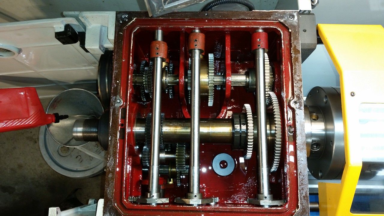

John Conroy
member
On my lathe it appears that they install the shift fork onto the shaft and tighten the set screw to hold it in place after alignment is established then drill a hole through the shaft and fork and install a roll pin to make the alignment permanent.
That's actually a pretty robust looking system on your lathe, John. Interesting
Mine has a few extra parts but suspect similar principal
