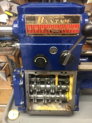

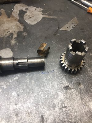

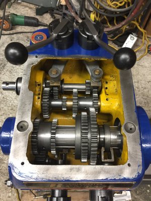

The guy with the punch and hammer strikes again only this time it's the housing for the main spindle taper roller bearing that is being wacked at. "Every time I hit it it spins so I'll just keep hitting until something happens"
Luckily he didn't harm the bearing, it still spins smoothly. Apparently the replacement bearings are silly expensive so hoping I can reuse them.
In order to remove the centre shaft I'd have to sacrifice one of the end bushings, they are in good shape so I think I'll just have to leave it in place and work around it.

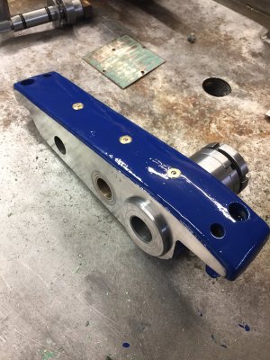

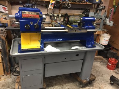

I've been beavering away at the Bantam, most of the 1/4" ball oilers got mashed up when removing them so ordered these brass 9mm ball oilers instead.

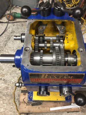

Headstock is back together, the gear train rotates smoothly. Almost finished the drawers for the base, still need to find some handles.
Once I get it up and running I'll do some test pieces on the Bantam and the SM10 and see how they turn out, would love to have two working lathes but there just isn't the space.

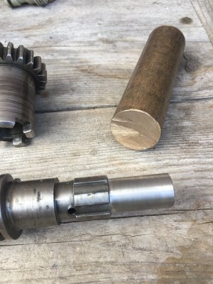

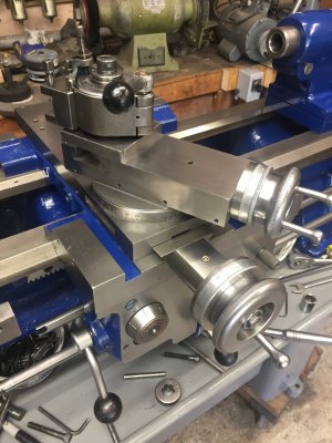

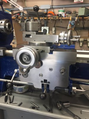

I got the saddle completed today, the gibs adjusted, feels great.
I thought I might even get the machine spinning but as I was installing the lead screw I realized I had completely over looked the bushing and badly worn lead screw shaft that spins in it.
The lead screw shaft was 5/8" in dia. hopefully turning it down to 9/16" will remove all the scarring, I ordered a 1/2" ID bushing so I can bore it out to whatever size the shaft ends up being.
Now I just have to find someone with a lathe that has a spindle bore of 1 1/8" or larger, the lead screw is 1/16" too wide to fit either lathe, what a pain in the butt.
You and I met on Saturday. My spindle will accommodate your needs. You are welcome to visit and I bet we can accommodate you.

I am probably 1-1/2-2 hours from you, but you are welcome to use my lathe as well.
Martin
I was at @Martin w place this morning and he graciously repaired the worn out portion on the shaft of my lead screw, he also gifted me a chunk of bronze to make the matching bushing out of.
Thank you sir, very much appreciated.
I did order a bushing from McMaster-Carr but it's at the border and I don't know when or if I'll ever see it.

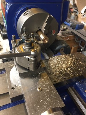

I got the Colchester Bantam making chips today! The lathe hasn't been leveled or aligned but I could resist playing with it.
