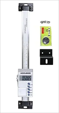

Change the order to 4-axis and watch the price quadruple. Jeepers Creepers! (still laughing about that!) And I'm still not sure I know what I'm getting! They just couldn't (or wouldn't) answer the question "Can I add z + Quill to get total z?"
In fact, when I look at the panel, I don't even see how additional functions like that would be accessed. There is no menu button that I can see. So I'm thinking this is a really simple box - what you see is what you get. But I have zero experience with DROs. Anybody here know more?

I started poking around looking at 4 axis DROs and ya the prices are anything from $500 to $1000+. I didn't see anything with 4 scale inputs and 3 axis display outputs. Some call the lathe function a combine function.
That Arduino combiner I posted sure looks like a slick solution doesn't it. I also found an off the self combiner for around $120. M-DRO Linear Encoder Summing Interface | machine-dro.co.uk

If you are considering an encoder on the quill that ties into the DRO box, the challenge will be where to mount the scale & encoder & not conflict with other functionality. Typically for quills people use these for that reason. I might be dating myself as the conventional encoders are getting smaller all the time but I think they are pretty thick compared to shown. Newall makes Microsyn ~ 6mm dia carbon rods, but big bucks & not sure it will speak your DRO language anyways.
