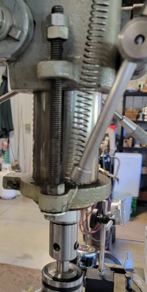

I'm betting that DRO has the option to combine the column scale and quill scale into the Z-Axis readout without having to push any buttons every time. It's called lathe function in my manual. I take it your DRO display unit has 4 input ports on it?

What you did is awesome. But sadly, I don't think that will work on any of my mills. There is no internal or external, access to anything on the quill except at the nose piece. I thought a bit about tapping the nose piece for a scale bracket, but I doubt it's a good idea to attach any kind of scale at the business end like that. :eek:

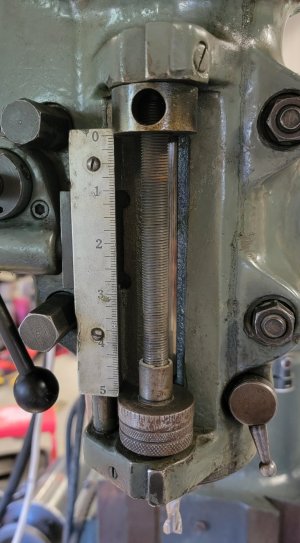

OK, so I was wrong. There is a place to do it on my mill/drill and my knee mills.
The nose moves with the quill. If the DRO parts are small enough, it might fit!
That vertical slide mechanism at the top of the limiter on the knee mill might work too! That the brass coloured part with a hole in it at the top of the threaded rod. But it could get real ugly real fast. Has anyone done this? Is it a good idea?

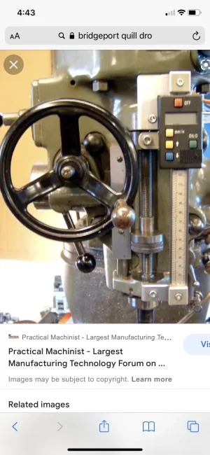

Yup, that's exactly what I was talking about. But I had wanted to put it onto the system DRO as opposed to standalone.
That way, I could take advantage of the lathe function (if it has one) to add the two Z's together as per @YYCHM 's comment above.
I'll have to take a boo at the link you provided to get a closer look at how it all fits together.
