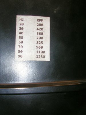

I have little doubt about the value of a DRO on my Bridgeport & Hartford Mills. And I'm pretty sure I'd like to add it to my lathe too. But I'm not convinced yet about the ROI for my old mill/drill whatever make/model it is. To be honest though, I am also worried that I might like it too much and then want to keep it and get rid of my old beaver drill press instead. The drill press has side bearings in it and I have used it for crude milling before I got the mill/drill. Too many BIG tools with overlapping purposes - some have to go.
Also has a tachometer using an Arduino microcontroller and IR sensor.
This is another thing that I think would be very useful. I have a hand held ir tach that I have used to measure speeds. It is apparent that the charts and readouts on the mills are just wrong. Often out by 50%. I can use the handheld anytime I want, but the convenience of a continuous readout right on the machine is hard to beat.
Too bad the DROs don't already have that feature built in. It would have been easy to do.
Some of the better DROs have tachometer and touch sensor interfaces. I'm just too cheap to buy them that way. Arduino tach cost maybe $30 to build and kept me amused for a few days hunched over a soldering iron. Electronic edge finder works on every machine. Learning rudimentary Arduino programming reminds me of learning BASIC programming back in the 70s.

My solution to instrumenting RPM:p
I made that chart up using a hand held optical tach.
I think some VFDs let you program reference points in and display RPM rather than HZ.

Sadly, you can prolly buy multipurpose tachometers for $15 or so today........ (Insert pouting face here). They are no fun, but if I am honest with myself, I've had more than my share of fun in years gone by.
Regarding that ocean - it's amazing what we have all been part of isn't it? Yet here I am today, repairing a mill, and learning to use it in my 70s. I hope I never stop learning. Life is sooooo wonderful!
For now, I've done exactly what @YYCHM did. Except my chart is handwritten instead of typed and mine has two columns - one for for hi speed and one for low. My priority is getting both my mills working to facilitate a decision on which one to keep. But I'm sure there is a tach in my future somewhere.
