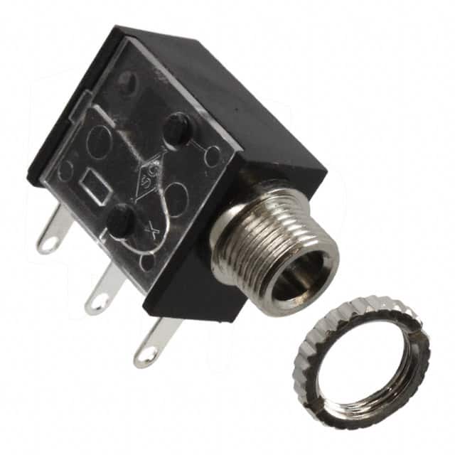

I'm now going to make a mount that secures an enclosed pcb mounted hall sensor to the lower face of the cap on the bottom of the quill. My pcb with have a stereo audio jack rather than the 3 pins shown in the image below.
25446179_bee22745-1f17-47ba-adc5-4118c7b97119_700_700
The smallest cable connector, allows for easy disconnection of the sensor cable as required.
Mounting to the lower face of the cap wont prevent any movement of the quill, so is preferable.
Beingon the bottom face makes the sensor perfectly located to read magnet array on the spindle that protrudes thru the central bore. I'll mount the pcb at 90 degrees to the two holes for a pin wrench so the sensor wont interfere with disassembly in the future if required. There is really a lot of real estate there to use as well.
