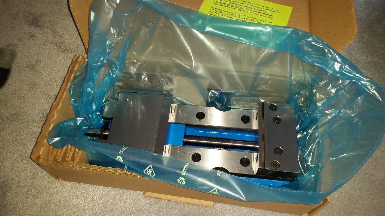

The vise that @Janger and I bought is an Autowell vise made in Taiwan, and it goes on sale for around 500$ from time to time. It is an exact clone of as Kurt 633 vise, which is a very solid vise that opens to the same 6 inchish that all the clones do.
I got my Kurt, brand new, from the same place, Thomas Skinner by doing a 3 step price match... I picked it up in Calgary for just over 600$.
On the mill, your most used item is the vise, and between your ways and the vise, is responsible for all of your accuracy.
I have sold all my clone vises except the Autowell, which I am convinced is just as good as, or better than, my Kurt.
KAR has it on sale at $558.00 Thomas Skinner will price match it. If you are in Hamilton, there is going to be a distributor that will give you the same price. As I said, you won't notice the difference between this one and the Kurt DX6, and I own both.

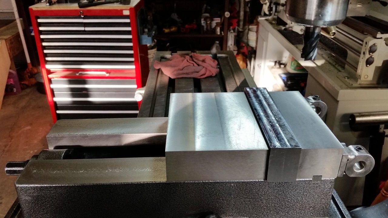

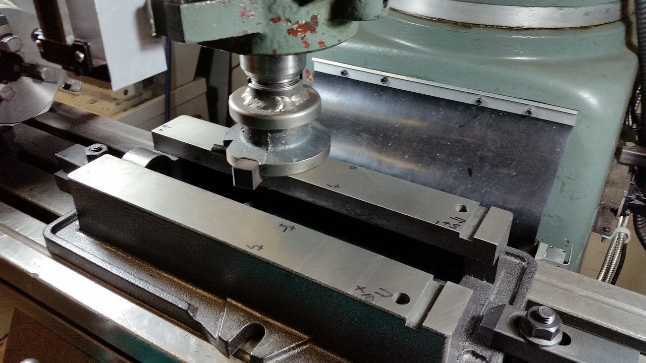

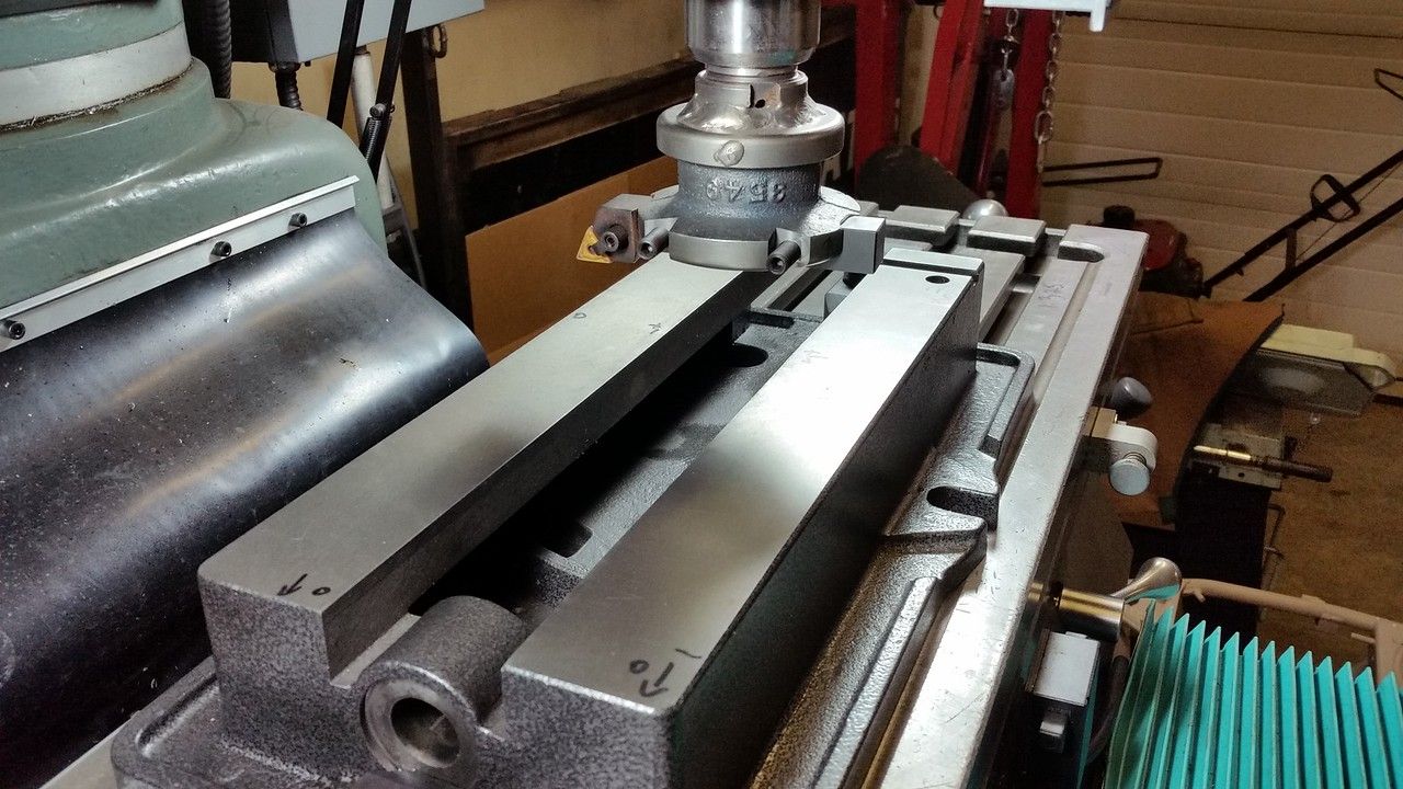

When I bought my first mill I also bought a Magnum brand 6" vise from KMS tools. I did some measurement checks on it and found that the bed was .010" higher at the rear than the front on one rail and .005 higher on the other.. I took it apart and used a flycutter to make the bed as flat as possible.
I also found that the fixed and moveable jaws were not the same height, both the permanent and replaceable ones. So after the bed was flat I also milled the jaws to match each other.
After all that the vise is pretty flat and square but I got frustrated with it's flexing when clamped tightly so I bought a Kurt DX6. The Kurt is a work art compared the the Magnum vise and the castings are so much harder and stiffer. It is a joy to use. I do still occasionally use the Magnum when I need 2 vises but I hate doing it.
