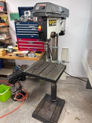

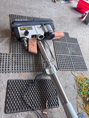

I've been thinking over (over thinking?) the repair that is needed to the table of the Craftex CX610 drill press I just bought.
I need a few bits of steel that I don't have and some time to put it together.
Or I can Frankenstein the Craftex and the Delta to do what I wanted in the first place - have a nice working drill press.
It looks like the head on each of them is just slipped over the column, and they both appear to have the same diameter columns.
The craftex is 3.617" and the Delta is 3.625" (0.008" bigger). I'm hoping the head casting isn't a precise fit...
So off with its head (and on with a new one).
That will really allow me to procrastinate on the repair of the table part, while forcing the repair of the quill handle.
Now I just need to work up the strength to lift those beasts off their respective columns (or laying them down and doing it parallel to the ground might be a smarter move).
Yeah right, yesterday. I can't remember yesterday.
No, I do need to get going on this project, only because the new to me drill press is in the garage, and I've just made a handshake agreement to become the owner of fairly nice 2002 MX5. Fortunately the car is about the size of a golf cart so I think I can squeeze it in without too much reorganization. So into the garage I go...

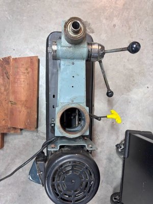

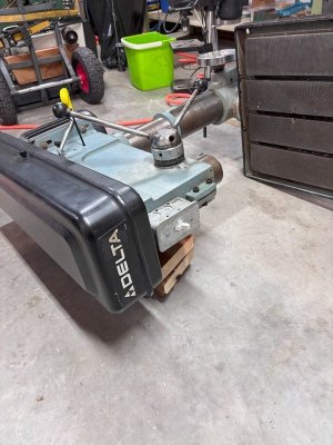

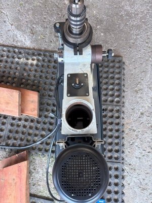

Allright - Frankie is alive!
Laid the Craftex on its side and removed the head, hauled it to the basement.

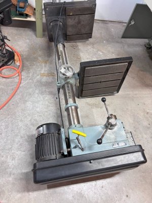

Laid down the Delta and took off its head. You can see the previous owners hack job on the quill handle, what you can't see is the oval hole for it in the head casting (worn out).
Mated the Craftex head up on the Delta column, these 2 drill presses are twins separated at birth as far as the head mounting goes - same set screw locations and even size & thread.
Had my son help me tip it back up as I'm getting tired today - too much activity.
And that is the reason the head of the Delta is still in the basement - no chooch left to haul it up the stairs today.

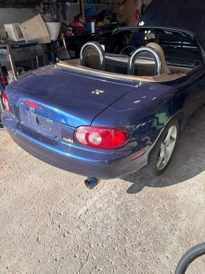

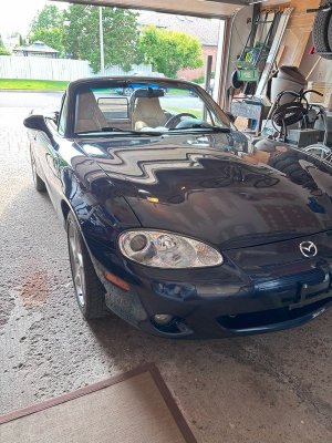

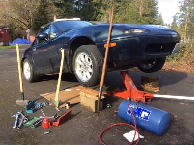

Added a new toy to the garage, should complement and not distract from metal work (I hope).
Its had a respray in its life but was done quite well, too hot to really get under it today (37°C without the humidity factor) but no rust holes in anything I can reach and nothing readily visible.
Needs an oil leak fixed (front main seal), should be a fun Sunday job, but otherwise is pretty much ready to go and very nearly stock except the muffler as far as I can tell.
