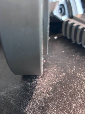

cutting corners to keep cost down I suppose. If it runs with 2 thou or less runout I would probably be ok with spending an afternoon deburring it.
Sounds like the 6 Jaw is a decent chuck albeit the shortcomings of manufacturing finishing and the socket head screws threaded too deep.

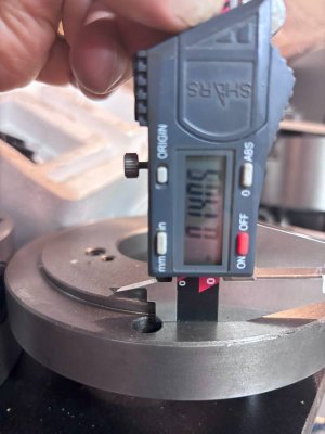

I was wondering if you can screw in a short grub screw of the same size / pitch and have it bottom out and then insert the pin locking screw?
The mfg defect is limited to the backplate that is a separate part from the chuck itself. Truly worst case scenario is I machine the backplate myself - redo the 6 holes clocked 60° from where they are now, but I'd rather try and make Vevor do some work. If it had been marketed as a factory second quality item with "known minor defects" and I'd bit on that I'd have no grief, but I need to have a little backbone and not accept defective items.

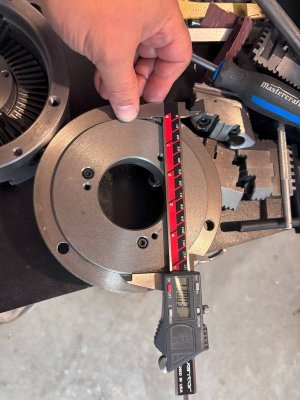

Question - is the backplate removable and could it be modified to set-true type operation?
While you have it apart, could you take some photos of the backplate interface?

If I were making some changes for the lock screws, I'd either
1. Machine an appropriate tube a few inches long and then part off small lengths to use as spacer sleeves, or
2. Buy screws with longer heads.
I don't mind cleaning up a Vevor chuck, and adapting a 6 stud D1-5 backplate isn't a huge challenge either - provided that there are no show stoppers. Hence my earlier questions above:
1. Is the backplate removable and could it be modified to set-true type operation?
2. While you have it apart (assuming you do), could you take some photos of the backplate interface? Is it a tapered register, a simple shouldered register, or just a flat bolted interface?
I’ll try and take a few more pictures either tonight or tomorrow. The backplate is removable but I’m unsure as of now if it’s adaptable to be set-true, or if it’s tapered or straight. It bolts on with 3 SHCS and I’ll grab the size of those. Still no reply from Vevor
Sorry about the mixed units, kinda realized that everything is metric and that would have resulted in the nominal numbers making sense. Like the 130mm diameter of the registration boss on the back plate and chuck. Its about 3.5mm (.140") high. The whole backplate is about 0.99" thick at its max, and about .788" on its biggest diameter.

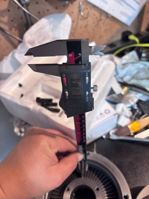

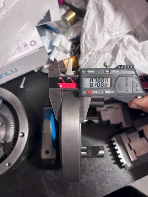

The boss has a square edge as best as I can tell. I don't think that its an easy mod to set-tru type. The distance between the back of the chuck and the pinion is ~10mm and the machined recess is about 12.5mm, if you toss the plastic backplate and instead figure out a way to seal up to a new modified backplate. You might be able to machine the backplate to sit in deeper to give a shoulder for screws to push on, but in my opinion is going to be right on the edge even with small screws, unless you get fancy with angled holes, etc.
I'll get an extra thick backplate so I can work out a way to make it set tru. I think that cams might be better than the normal jack screws because the thickness of the shoulder register issue goes away. Worse comes to worse, I won't be set true. Big deal. I have a collet chuck that I use more often anyway.

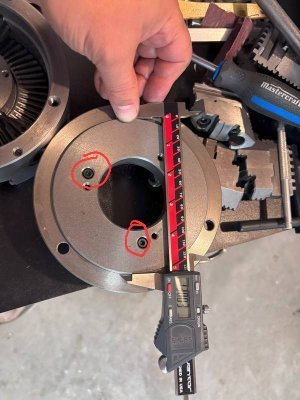

Another question. What are these screws for? I've never seen screws there. I've highlighted them for you below. Shouldn't they be on the other side of the plate? Did you put them in backwards?
You can see the plastic backplate / cover in the 2nd (removed and lying above) and 3rd pic (installed) in post #30 of this thread - the one where I start talking about this chuck.
I didn't fully explain my misgivings with the backplate. The locking screws were the first thing I noticed not being right. Later on I became uncomfortable with the fit of the threaded cam studs in the back plate - very loose fit for a relatively fine thread, plus with the clearance hole being drilled and extra few millimeters, and the ends of the threaded studs being chamfered means that there are only maybe 8 turns engaged with a very loose fit. I know only 3-4 threads engaged are really doing all the work, but the loose fit just started eating away at me.
The things you circled are the ends of the camlock studs from the chuck side of the backplate, with the little locking screw holes beside them.
Ah, I see. The plastic thing is not a backplate, it's an internal cover of some kind. The backplate itself is still cast iron. I'm good with that. For me it doesn't matter anyway as I will need a D1-5 backplate which Vevor does not offer.
Really! They appear to have allen hex heads on them! But I can't blow up the photo enough to see that for sure. In any case, I accept your explanation.

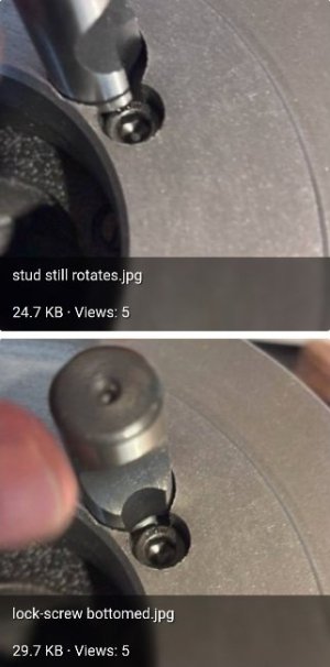

So we are on the same page, I include a screen shot of the lock screws you posted a while back.
Notwithstanding your concerns about the cam lock studs themselves, I would not be concerned about the lock screws enough to relocate them. It isn't necessary. They do not carry any significant load. Their only purpose is to prevent the cam lock studs from rotating while not installed on the spindle.
Nonetheless, as your second photo above shows, they don't do what they are supposed to do and that has to be fixed.
To work properly, they should fully engage the indexing relief on the camlock stud. A washer beneath the screw would work, but you would need a stack of them which would increase the odds of the stack coming loose. I'd make custom sleeves instead that raise the head of the screw just shy of the backplate surface. You wouldn't want them proud because that would interfere with the integrity of the backplate to spindle connection.
If this were mine, I'd identify which of the three screws is the shallowest and then make 3 steel sleeves (very thick washers) that would raise that screw just shy of the surface. Just use a depth gauge (caliper depth function is fine) to measure the backplate surface to screw head dimension and then make 3 sleeves say 10 to 15 thou less than that. Easy peasy on your lathe. Precision is not required.
basically all the issues are with the backplate, the chuck is fine except for the copious amount of deburring required. So if you are making your own backplate, then its pretty much a non-issue.
I put the chuck all back together after deburring, and then I realized that I missed 3 places - the edge of the holes for the pinions... I'll do that later today.
And yes, I'm just going to make a spacer / thick washer to space the locking screws up. As long as they are tightened they aren't going anywhere - they're trapped by the spindle nose so can't really back out. Its just about having it be to my liking a the end of the day.
