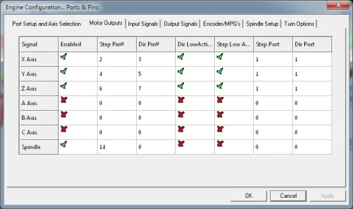

In this case the spindle step pin would be set to pin 14 and no direction output.
Then under spindle set use Spindle Motor Output and PWM control and 5 kHz
Now MACH will create a PWM signal on pin 14 that is 0 when spindle off and fully at the Pin 7 VFD-10V value at full speed.

Hi John! made those changes. No output at pin 8 could I have something configured incorrectly? I made the changes to the step dir as suggested and entered S1000. I reset the over ride and it changed to 100% is there something else I need to do? I will research this afternoon.

CTRL-SHIFT-PrtScn to capture the screen. Then paste it into Paint or some other graphics program and save as a jpg or bmp file. Paste that here so we can see the MACH setup screen for the spindle. Like I did above.
I believe I have all the settings I know about correct. But..... we've supplied the 5V signal to the G540, the relay is connected properly as it fires when the spindle is activated. what makes the circuit between the 5V source and the reduced voltage pin (8) to adjust the motor controler? Pin 14 on the parallel port is how it is transmitted but I'm not sure I've configured anything to turn it on with the spindle. not sure I'm asking my question well but hopefully you understand what I mean : )
Here you go! I took one of anything I thought might help : )

Actually they do help. I disabled my direction relays and then it complained because I didn't have direction set in the spindle on the Motor Outputs screen. I will try it the way you have. My Break Out Board connected to the USB Smooth Stepper has LEDs on PIN14 and PIN16 which I have set as speed and dir. I'm not seeing it come on so I may have to haul out the scope.
Also the 50kHz for your PWM rate may be way too high. Drop it back down to 5kHz. The filter circuit in the G540 may not let that high a frequency pass.
