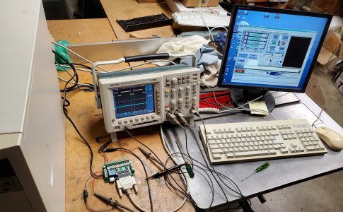

This photo shows the top trace of the scope showing DB25-1 which is the PWM from MACH3 25kHz. Bottom trace shows the DC voltage out from the PWM circuit. Speed is set at 750 RPM with a max speed on pulley 1 of 3000 RPM. So we get a 25% low period duty cycle and about 2.5V on the scope. The PC is 1GHz, 512MB memory WIN-XP and originally ran MACH2 when I was first testing the ELS so it's circa 2006.

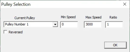

Make sure your pulley #1 max speed is set
and verify that on the Alt6 Settings screen.
It appears to be that number and Max Speed aare used when you do the S3000 G-Code and that creates the 10V. If you do S1500 then it would make 5V. Now if you see closer to 10V at S30 then you have to invert the Step Pulse.

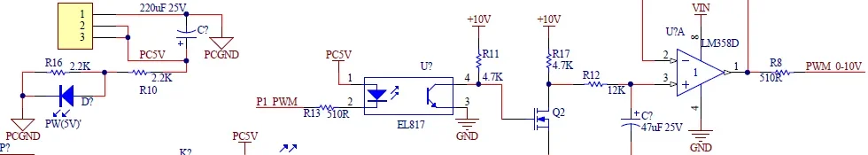

One other thing. If you are using a meter to measure things remember that the VFD GND is separate and isolated from the PC GND. So in the drawing below the PC5V and PCGND come in on the little connector on my BoB. The PC5V pushes current through the EL817 out the P1_PWM pin out to the PC which pulls it to PCGND and therefore turns on the Opto.
Notice the other side of the OPTO and the PWM output is referenced to GND. That's like the VFG GND on your Gecko. So you can measure the P1 pin (or P17) on the PC side relative to PC GND but you have to put the meter black probe on the VFG_GND pin on the GECKO to measure the VFD voltage. So POS 5 and POS 6 on your Gecko have to be measured relative to POS12.

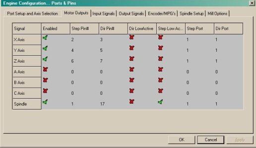

I think you may have missed my point. Once you are using the Spindle Control the Motor control step/dir signals are in use. That means you can't have the same direction pin enabled as an output. So yes, the old way has worked but it's not the way you are doing things now. I think that's why my version of MACH bitches at me when I have the spindle Step Pin assigned but nothing assigned to the Dir pin.
And if I assign Pin 17 to the Spindle Dir and I also have it assigned to Output 1 then it complains again because I'm using it twice. So I have to disable the Output 1 as I want Pin 17 as Spindle direction. And then in the Spindle Config screen I also have to disable the Spindle Relays.

In my case the little BoB has that 5V PWM to 0-10V DC converter. I could also pull out the stand alone ones but since I have a scope I don't need to. I'll see if I can get some more screen shots for you.

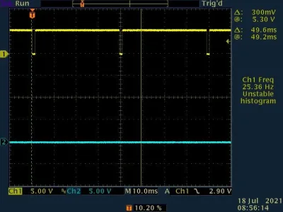

Alright. Went back to the system. Found a 720K 3.5" floppy so I could do some screen saves from the old TEK scope. Let's start here: This is the version I'm running with screen shots from the actual hardware.
Now let's take a look at the screens. Notice I have Pin 1 set as STEP and Pin 17 set as DIR. On the BoB Pin 1 goes into the PWM circuit to create the 0-10V and pin 17 runs a relay that can be used to switch motor direction. Much like what you have.
Next let's go to the Outputs screen and make sure nothing is set.
Finally in the Spindle setup screen we have disabled Spindle Relays, Use Spindle Motor Output with PWM control. PWM base frequency is set to 25kHz.
Apply and save and then from the Config menu choose Pulley Selection. I want Pulley # 1 to be the current pulley with a max spindle speed of 3000 RPM and that's the motor RPM since the Ratio for the pulley is 1:1
Now let's run it at 100 RPM in the CW direction. The relay on the little board is OFF. The top yellow trace is the PWM signal (active low from 5V to 0V) showing a very small pulse for 100 RPM. The direction signal is the blue one and is low or 0V.
If I type in an M4 on the MDI screen I want to reverse the direction. The relay comes on.
And the direction (blue trace) changes to logic 1 (5V).
Now let's go back to clockwise which is blue trace low and this time 2800 RPM which is almost continuously ON for the PWM (logic low since it's inverted) with just a short time OFF (logic high)
At this point as long as there is a module connected to the PIN1 with that 5V PWM I can create 0V to 10V which this little BoB does. But I could use an external module too. Or in the case of the Gecko it routes Pin1 through an optical isolator over to the PWM to DC circuit and puts it out on VFD_PWM with the supply for the isolator coming from VFD_GND and VFD_10V.
The scope leads in the above samples are on PCGND and the buffered PC Parallel Port signals.

Pretty sure the PWM base frequency is in kHz not Hz but if you are using a smooth stepper then 50kHz shouldn't be a problem as long as your kernel speed is also high enough. I was running a 25kHz kernel speed on the parallel port so getting the 25kHz PWM isn't an issue.
And you didn't say whether you had turned off the Relay Control for Disable Spindle relays and set the port direction bit to that relay bit as shown above in my screen shots.
If those things aren't correct it's hard to know what MACH will do as an input into the Gecko. And without a scope you can't confirm what's going on.
So three things:
1. PWM frequency less than kernel frequency.
2. Disable Spindle Relays
3. Set Spindle Step and Direction pins.
