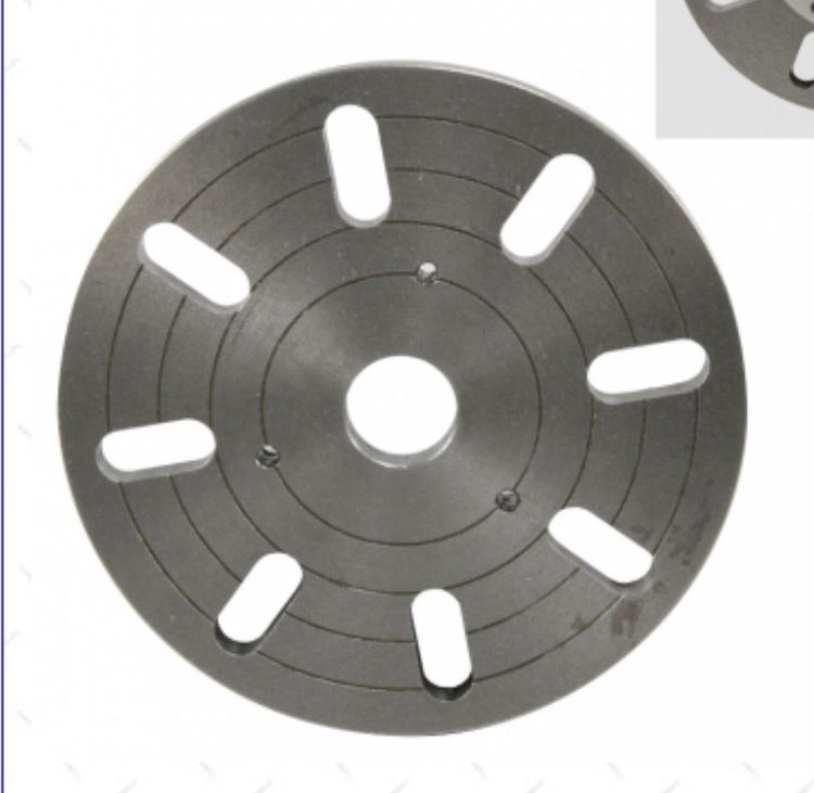

Do you want a faceplate that you can mount work on?
or one solely for driving a dog?
Started my face plate today @YYCHobbyMachinist - I have a D-3 spindle verses your treaded spindle so I have an adapter plate to connect to the face plate - there will be some machining to reduce the weight of the adapter. The landing of the adaptor will be a nice “fit” into the back of the plate. The plate will have a recess to accept the landing.
The face plate is 7/8” thick and 9” diameter. The mission is to mill T slots for holding and perhaps a drive slot for lathe dogs if required. As mentioned earlier in Craig’s thread, the easy way to turn between centres is to renew one in the three jaw and ride the lathe dog on a jaw. I thought to mill the disk on the rotary table (12”) so I have a chain fall lift for this:
had things all set up and realized I do not have the other jaws for the chuck - I have the inside jaws bit not the outside jaws. Anyone have a set of 8” bison 3 jaw outside jaws??? - anyway - went on with set up - this is just messing about with the coaxial centring gauge - this thing is cool - LOL -
So since this pic I have moved the face plate onto 4 x 123 blocks and dogged it down. Also bored a 1/2” hole in the centre to start the process.

I'm starting to think making a FP is the better option otherwise it's going to be a $200 touch on eBay.

I picked an adapter like this
https://www.leevalley.com/en-ca/sho...-stronghold-oneway-scroll-chucks?item=66B1207
to fit a oneway woodchuck on my Southbend. It fits nicely on the 1-1/2x8 spindle. It might be adaptable to a DIY faceplate.
That's brilliant John. I have a person locally selling plate steel as weights. I can order a plate of whatever dimensions I want, and assuming the adapter is steel and not cast iron, TIG the adapter onto the plate and turn it flat and true. :D
