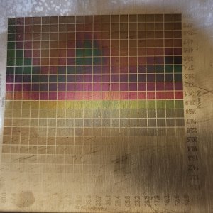

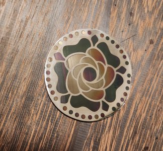

What's the difference between the first two images?
I gave a description of the difference in the settings on the engraver between the engravings in the first two images. The second one is slightly lighter because it traveled at a speed of 2000mm/s instead of100mm/s both at full power and a frequency of 20khz.
