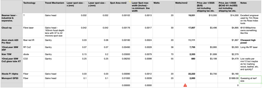

More machines added to my table. @jcdammeyer I added the Xtools higher end Galvo head and also another machine the monoport GP20 galvo head, it's cheap but the specs were not clear.
The XTools F1 Alpha Galvo head now has the highest power density in my table at 22,222W/mm^2, even higher than the Beamer, . Really small laser dot/kerf at 0.0012". Assuming it is an accurate specification. I'm sure the beamer spec is accurate, the xtools, hmmm. It's a bit of a hype type company.
I'm now thinking I want two lasers. 1. A gantry type to do wood and big pieces both engraved and cut. 2. a small galvo to do high quality marking/engraving on metal. Come on forum help me spend a lot of money. :p
I wondered about xtools. As I know nothing about lasers or what a Galvo head is I suspect like many, i'd probably buy into the hype and purchase one. Luckily I don't have room at the moment.
