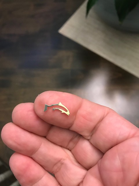

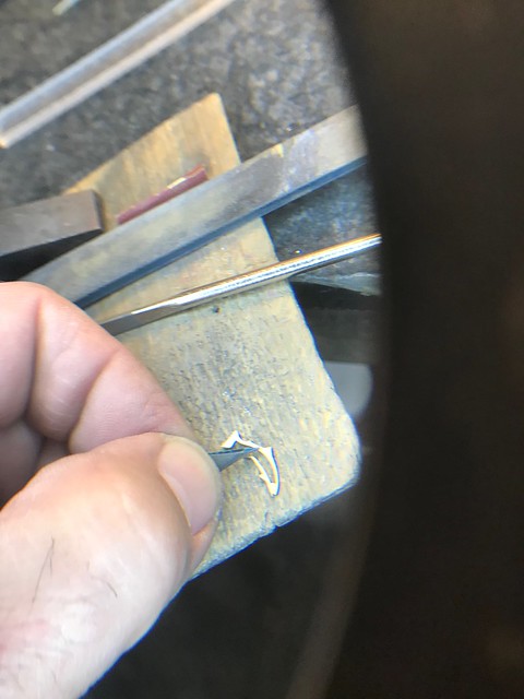

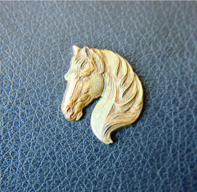

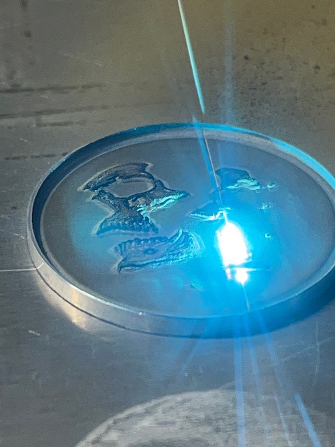

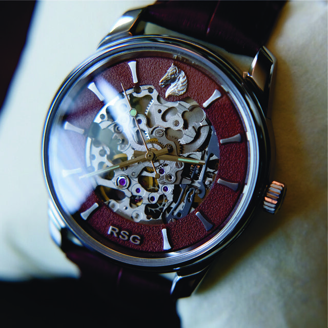

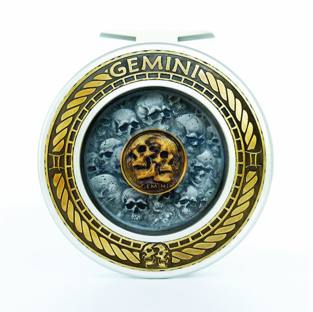

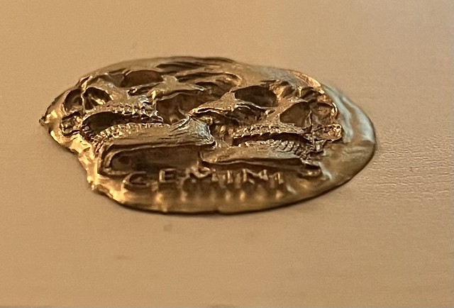

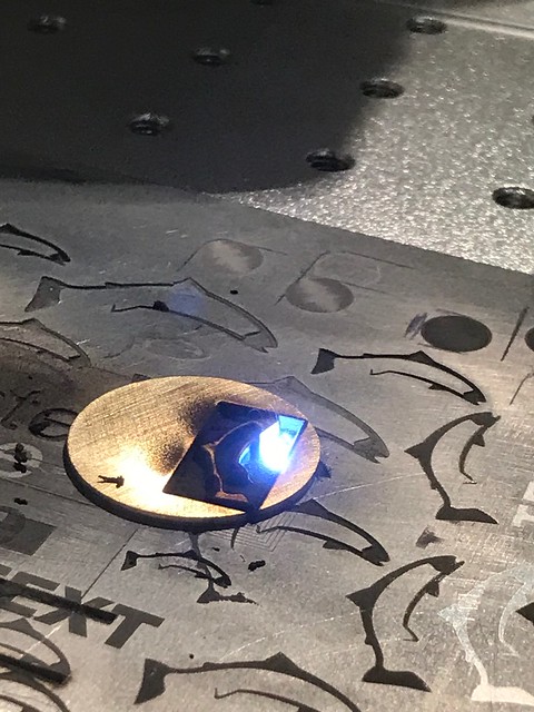

Yes, but you have to remember the cutting/engraving footprint is small, 5" dia max. with the lens I have. Materials such as stainless, O1, aluminum. brass.....basically any alloy. It's obviously not practical to use it to cut just anything but small complicated geometry, parts for my watching hobby and reel making hobby it's perfect. It shines when it comes to deep engraving mostly. Typically most of the stuff I cut is around .030" thick but I've cut as much as .100" at times, just takes longer. If you were to need it more for cutting you'd likely want something in the 100W range.
Hers's some stuff I've done....

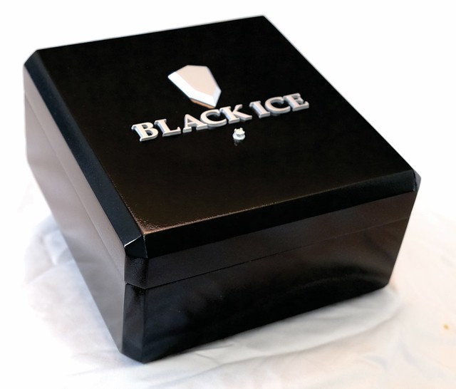

Hers' some .100" aluminum letters for a reel box (with a real 1/2 karat diamond)

@1018Machine laser— fibre —30watt, can cut many metals well at 0.30” thick, speed?, slower at .100” thickness. Looks to engrave very well to depth of ?, speed? possibly extreme samples would be the skulls and horse head in post #2.

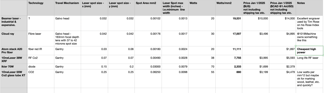

The beam size and optical power I believe directly relates to the engraving and cutting capabilities although it is poorly stated everywhere. I believe this is similar to using a magnifying glass & the sun to burn wood. The tighter the focus the hotter the point of light, but it's smaller. So a 20W laser with a very small dot size could have dramatically higher power per square unit of area. And conversely a strong laser with a fuzzy dot could actually be slower and less capable. Although it depends on what you want - a big fat black line with the small laser dot size would take many more passes, the fuzzier dot would take fewer passes but with a slower travel time. There is a limit where a diffuse beam does not do anything - e.g. like how the magnifying glass with a 1/2" circle does nothing.
Trade offs as usual... But what laser strength do you need and what dot size to engrave metals, plastics, wood? Or maybe what can I get for $2000 to $3000? And do you mean "marking" or "engraving"? The horse above from @1018Machine is a great example of engraving. (What material is that horse @1018Machine ?)
Also the wave length (colour) makes a huge difference, an IR laser is much more capable for engraving/marking a wide range of materials.
Taking the machines @Chris Cramer mentioned and some others see below for analysis. @Chris Cramer looks like the prices on these machines have fallen just recently? I think the AtomStack A20 pro Fiber and the 1OneLaser XRF are compelling with watts/mm^2 around 10,000.
If anyone spots any errors in this please let me know....

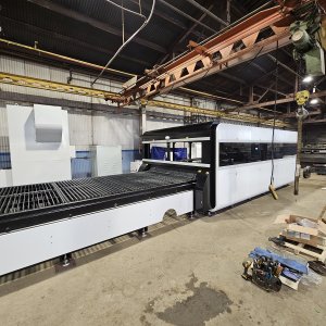

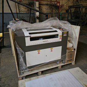

I've got one, supposed to be 150 watts. It has seen zero use, all I've done is pry the lid of the crate off to have look. I imported a 12,000 watt laser for work and negotiated to have the small one thrown in. Shipping was free, it piggy backed in the containers of the big laser. Seemed like a great idea at the time ..... still sitting in its crate while figure out how to fit it in, get it through a doorway and down the stairs. Disassembly required.
The big one (during assembly a year ago) and the little one, alone and forlorn

since no one else said it yet, I'll take that off your hands :p

At 30 watts it cuts surprisingly faster than you'd think. Obviously higher wattage machines can cut faster but when it comes to 2.5D engraving even the larger machines need to run at lower power or it just ends up burning everything. I've never tested how deep I can engrave but I have gone as deep as about .25" you just need to continually lower the gavlo head to keep it in focus.
