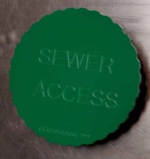

The other day when I was mowing with the garden tractor and the new non-mulching blades the suction was enough to pull up and chop up the plastic sewer access cover.
Time for some CAD and 3D printing. Painted because PLA won't handle long term sunlight.

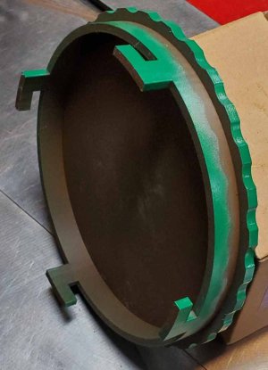

And this one has tabs so that it can be inserted, twisted and locked down.

What did you paint it with & do you have any prior experience how the PLA is holding up?
It doesn't do well in the heat of sunlight and I may find that I will have to reprint this in some other material. What is needed is a much denser infill.
For example, try #1 with the keys was printed with 15% infill and the mistake in the design was the retention hooks weren't far down enough. I've had this sitting over the sewer access in the sun.
So it's got the cooler air from the ground on the bottom and heated from the sun on the top. It's badly warped. Dished down in the middle and twisted. Hard to see in the photo.
The new painted one is now out there and the hooks are under those ridges. Plus this one was printed at 25% infill which given the thickness means less air inside. Hopefully it won't warp.

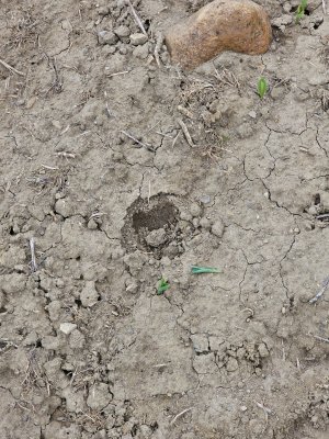

Welcome to farming.......
As I write this, my corn fields are being destroyed by birds. They don't even eat most of the damage. Just yank the baby corn plants out of the ground hoping a seed comes out with the tiny little sprout. In case anyone is wondering, yes the hole is a deer print. The deer, ground hogs, and rabbits attack next.
