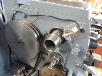

YotaBota
Mike

whydontu
I Tried, It Broke
Lee Valley - https://www.leevalley.com/en-ca/sho...disc/73479-adhesive-backed-rare-earth-magnets
The adhesive on these is tougher than the magnets. Trying to remove one will break the magnet before the adhesive gives up.
Only snag is the sensors are polarity sensitive so if the adhesive is on the wrong side it won't trigger the sensor.
If the tach you bought is the same as my $15 Amazon one then the polarity is correct.
I'd be happy to send you a couple of 3/8" ones from my inventory...
Dusty
(Bill)
Is this the one you have? https://www.amazon.ca/DIGITEN-Digital-Tachometer-Proximity-Switch/dp/B01FQMI18Y/ref=sr_1_14?crid=3RI2YR4O2XNJF&keywords=digiten&qid=1653257383&sprefix=digiten+,aps,166&sr=8-14
This is the same one I have and mounted on the back side of the spindle, no balance issues and epoxied into the sleeve. I made the bracket for the sensor and the threaded hole was already in the headstock.

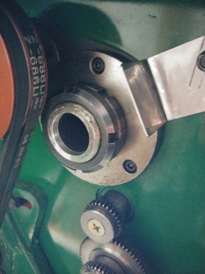

@YotaBota hey Mike yes my tach kit came via amazon shortly after I started into my right knee surgeries so this upgrade project has been on hold for some several years. Popped out to the shop and took this photo, as you can see my unfinished bracket which is also held in place by an existing bolt. My bracket is made from aircraft grade stainless steel, what else? Unfortunately my spindle doesn't stick out except for the two locking nuts. Not a whole lot of meat there for magnets to hang on to and stay away from migrating towards the head stock, that is why I suggested using lock tight. Good to hear you have no balance issues using a single magnet. I have both a red and green digital screen, much will depend on lighting interfering with readout.
This solution is about as easy as it gets. And it's a direct output solution. If one wanted to, you could make a ring collar that Clamps to the rear side of the spindle and add additional magnets with the appropriate division factor to improve resolution.
Balance is a zero issue. How can that tiny magnet compare to an unbalanced work item in the chuck jaws.

@YotaBota hey Mike yes my tach kit came via amazon shortly after I started into my right knee surgeries so this upgrade project has been on hold for some several years. Popped out to the shop and took this photo, as you can see my unfinished bracket is also held in place by an existing bolt. Unfortunately my spindle doesn't stick out except for the two locking nuts. Not a whole lot of meat there for magnets to hang on to and stay away from migrating towards the head stock, that is why I suggested using lock tight. Good to hear you have no balance issues using a single magnet. I have both a red and green digital screen, much will depend on lighting interfering with readout.
You could glue a small magnet into one of the square wrench notches.
Better yet, make a rear spider that you can use for other things and build the magnet holder into that. The spider could be clamped from inside or on the narrow lip, or screws drilled and tapped on the end, or drilled and tapped onto the rear most nut. Obviously it works with the existing wrench recesses so it will work just as well with some threaded holes or even lock screws that engage the wrench recesses. Lots of options. Looking GREAT!

@Susquatch Yes thought about using a wrench recesses however that demands a tiny diameter magnet, likely wouldn't work. Guessing with that!
What in heavens name is a rear spider set up? Pictures please!
Not all sensors are polarized. Some work both ways.
Small very powerful magnets exist. Search for neodymium magnets.

Since your spindle does not stick out of the rear of your lathe, the easiest way to attach one is from the inside. Basically, you are adding a small chuck to the backside of the lathe. Its almost as easy to add it from the inside of the spindle as it is from the outside.

@whydontu said 'Only snag is the sensors are polarity sensitive so if the adhesive is on the wrong side it won't trigger the sensor.'
Can you expand on this as my instructions say nothing about polarity.
The mag sensor works best when it is sensing the N pole. If you move the sensor towards the magnet, on one face of the magnet it won’t trip, on the other face (N) it will trip about 6mm away.

Does your E-box allow for more than one sensor with a divider circuit? If so, use 2 magnets or even 4 to smooth out the display at low speeds.
I'd be using @whydontu 's square magnets before I'd be making a spider. But I'd still be making the spider for its own sake down the road. A rear spider is a very useful addition to any lathe.
