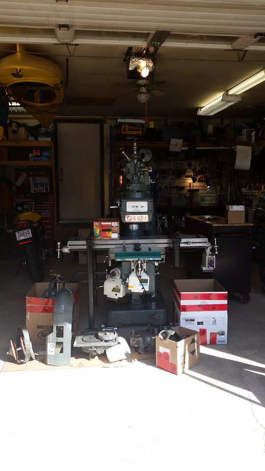

I need some fresh eyes to look at my lifting set-up. Safe or Not?
@John Conroy You are taking a risk in bolting to the table. Use a 2000lb ratchet strap to the base, and lift the top corner with that. The maximum load from that point will be around 700 lbs.
I'd feel bad if the table blows out.
Agree with Dabbler about using the t slot for any serious lifting. Lifting strap to the base is best from my point of view.
I think that could mean it could tip really easily. The center of gravity would be above the lifting points. I would not do this.
I’ll ask because I’m curious then
What’s different between lifting from the base using chains versus lifting below the base using a forklift?
I’ve moved dozens of machines with a forklift under the base, ones much heavier than this machine. Just asking
@Chicken lights I never lift using a chain to the base. lifting straps only. I use chain when I need to use the chain hook - that is, where it an lift without touching paint.

Everyone does things differently. If you don’t ask why you don’t learn
Thanks for all the input everyone. Dan and I have decided to play it safe and he's going to rent either a level load trailer or a tiltdeck. I'm going to put the ram and head back on but leave the head inverted to lower the CG. Hopefully the weather cooperates. Pick up is scheduled for this weekend.

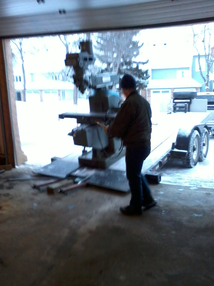

How did you get it in your shop in the first place?
This morning I put the ram and head back on, now that I have done it twice it's a piece of cake. The machine is sitting on skates and everything is ready to go including a few boxes of spares that came with the Ferro when I bought it. My wife is getting cranky because she can't park in the garage until this is gone, at least the weather is good.
We used a tilt deck trailer and let it slide down controlled by the winch and landed it onto the skates. It was -25 degrees the day so no fun. Moving it around in the shop is easy with a toe jack and skates.

John and my neighbour are going to use this trailer.
Looks like it should work in conjunction with some skates or rollers and a winch.
Looks great I want a trailer like that.
I picked up the trailer from the rental place yesterday and delivered it to the neighbour. It is a neat design with a ramp and roller on each corner and a hydraulic ram in the front. The only problem is that it is super heavy. 16 feet and 4000lbs. Les was having trouble with his truck overheating pushing the wind yesterday. Should be an interesting drive home with another 3500 lbs on it. He should be near or at John's place now doing the load out. If you happen to pass a mill on a trailer on the side of the highway between St Albert and Regina, you'll know the trip didn't go as planned.
