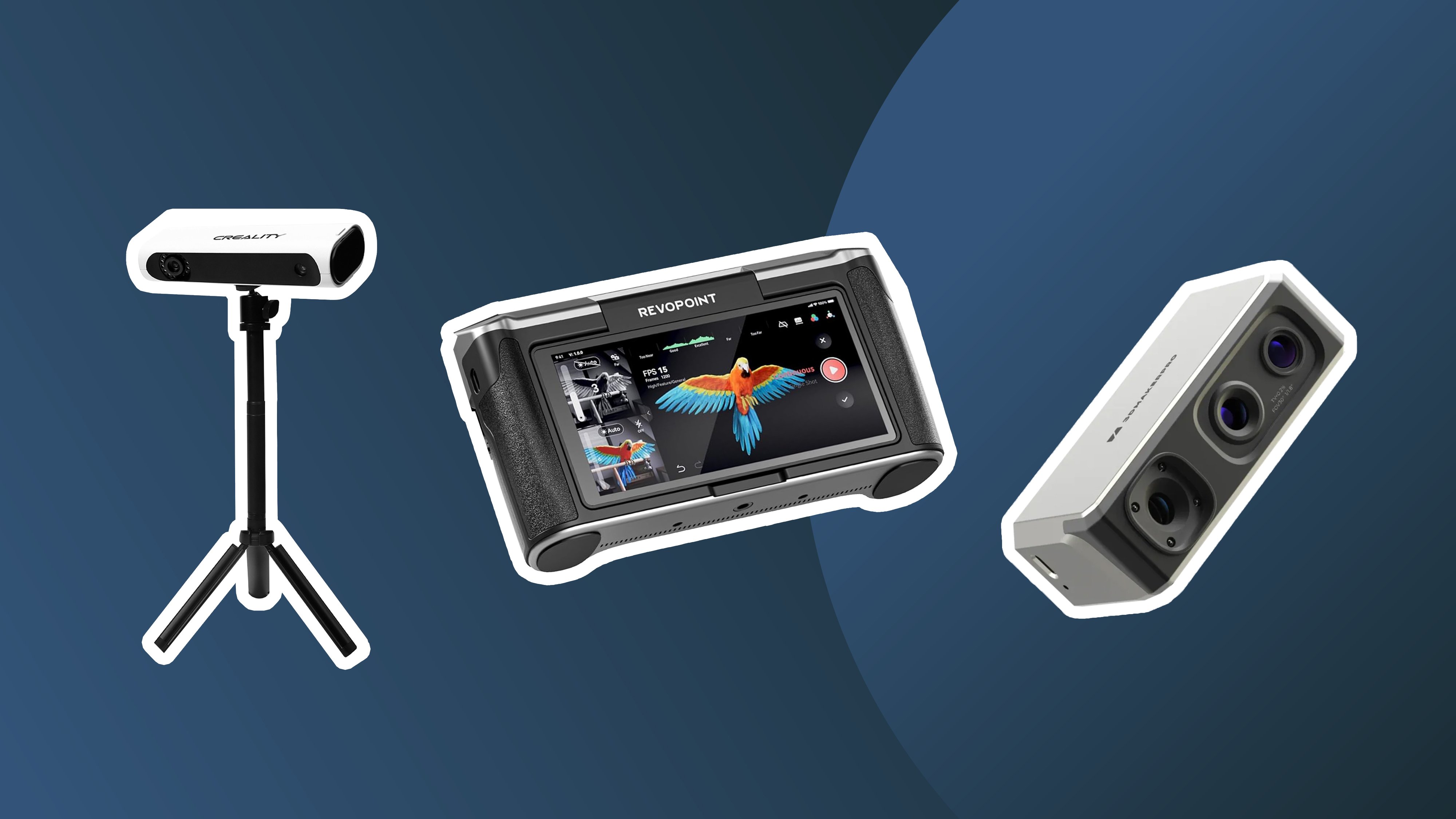

I've seen different results on one 3D scanner, hobby type, the creality ferret pro 3d. It has anti shake tech to supposedly improve results. I've read an article and seen a video. In the video I am not especially impressed with the results. He gets a part that's good enough for his application but It's hardly a nice copy.
In another article https://the3dprinterbee.com/cr-scan-ferret-pro-review/
the author scans some 3D prints and makes pretty good copies of them.
So one is a nay and one is a yay I think.
But... I want to make copies of parts like in the youtube video which had poor results. I don't need to make copies of 3d printed figurines like in the article. Scanner specs claim some sort of accuracy like 0.05mm or 0.1mm but in the part video that does not seem to wash to me. All the detail in the part is lost and it's just kind of a mashed potato copy of the part. @Matt-Aburg can you please weigh in with your experience and explain what you can about the differences in results? Or anyone else of course who has experience with this tech.

It is not just accuracy that is important. Resolution is very important especially on tiny parts like you show. I will give a sketch tomorrow that explains this better. Even if the accuracy is better, resolution is the distance between points. A point distance of 0.16 vs 0.05 is a big difference. accuracy of 0.1 is actually 0.004 inch.. so the error will compound bigtime. This is why I would not got with the Creality product (or any creality for that matter).. The best inexpensive choice is Revopoint. See charts below.. and new review..
Just so you know, I do not endorse either of the two product I mention below... These are simply not good enough to get reliable results and you get what you pay for...
Creality
Revopoint
This is a good point. It's the point I tried to make earlier about the difference between CMM and Scanning but Matt has explained it much better. Quality control can be done by selecting specific points, but replication of intricate parts requires high resolution. Usually scanning also requires a skilled operator to fill in the details when the scanning isn't perfect.

So far on the inexpensive side, Einstar wins the race in my opinion... You might think that 1K is not cheap, but it is on these things... Just remember that if you pay 2-500 for Revopoint, or Creality... they will end up never used, sitting somewhere getting dusty. If you want a tool, it just simply will cost more than 3-500.. I will get the sketch later or find a video to explain it..
