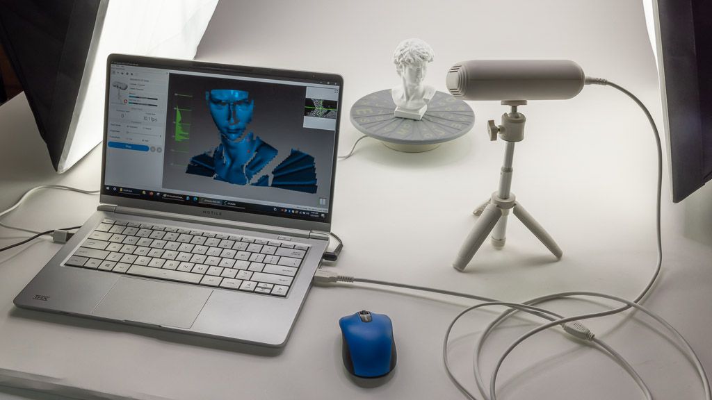

I want a star trek replicator. To scan stuff, accurately enough, and then 3D print it. What is required? what is the process? What software is needed? How much for various options? Does it take forever? Can I measure and model it in CAD faster than the actual process of scanning, cleaning, printing?
See this holder for hex shaped bits? I want more of them. How can I scan this with some sort of scanner? Then model it up and print it with a 3-D printer.? If I can do that then I have a 2023 version of a Star Trek replicator.
Somebody on the floor must be doing this. Tell us about your scanner in the process and how much the scanner will cost.
For that clip holder, I would scan then only use it as reference geometry. It looks like one holder could be pattern copied. This probably would not warrant the cost of a scanner to do in this case. On more complicated objects, you could scan, clean up, and print. The scanners range in price from a couple hundred to 100,000$. Of course, you get what you pay for.. If you want a good starter scanner, I would recommend either a Peel or Einscan scanner. These are not metrology grade, or certified scanners. They would do the job though. You will still need to clean up and redraw the part if it is prismatic. For organic, you can auto-surface it. For 3D printing you can leave it as polygon mesh. Here is in my opinion of a starter scanners.. I would avoid Creality lizard or anything that costs 2-300$.. you really get what you pay for.

You are referring to structured light, with feature recognition. As in the video of Einstar, it loosed tracking often. Laser is way better because it uses markers that define space related to the camera. I doesn't need spray to lighten dark surfaces and can work in practically any lighting condition. Unfortunately, the cost of a start laser scanner is over 10 K.
