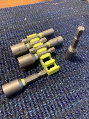

I want a star trek replicator. To scan stuff, accurately enough, and then 3D print it. What is required? what is the process? What software is needed? How much for various options? Does it take forever? Can I measure and model it in CAD faster than the actual process of scanning, cleaning, printing?
See this holder for hex shaped bits? I want more of them. How can I scan this with some sort of scanner? Then model it up and print it with a 3-D printer.? If I can do that then I have a 2023 version of a Star Trek replicator.
Somebody on the floor must be doing this. Tell us about your scanner in the process and how much the scanner will cost.

@Matt-Aburg can scan that. But..... you should take a good tall drink and be sitting down when he gives you a cost.

Stop! Guys! Rabbit holes! :) ::p:cool::oops: I want to scan stuff in general. and then print it. The hex holder is just an example of the kind of problem. So how do we do scanning? and then how do we fix the scanned model? and then we can print it?
Scanners have a huge cost range and capability range. From your iPhone! really! and some iphone apps. to hundreds, or thousands, or tens of thousands. handheld systems, systems that use a little automatic lazy susan, laser units mounted on tripods like a laser level. It's just amazing. We had a processing plant scanned at work, inside and out,. You can fly through the whole thing and see everything including colour, dark corners, dirt. It's like a video game. and tens of GB in size. You can't move the data over wires you need to mail hard drives. You could research this for days.... and I have. Somebody who knows tell us! we need an article.

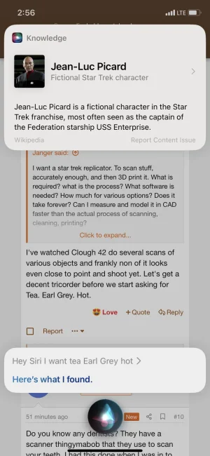

Hmm let’s try that.
