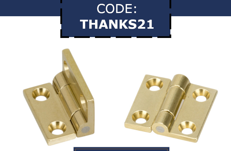

Here is something close on Ali
And here they are at Brusso
Pricey little buggers (https://www.leevalley.com/en-ca/shop/hardware/hinges/small-box/40459-brusso-box-hinges?item=01B0301)! Have you considered treating your wife to candlelight dining or a spa treatment while waiting for Lee Valley to replenish their inventory?

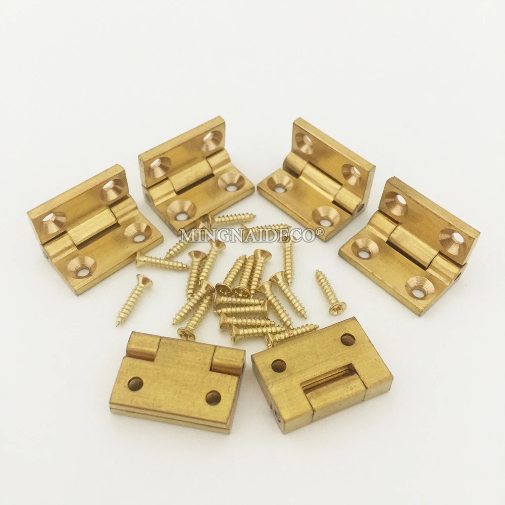

They are back ordered through Brusso though ali is as possibility I will just have to hope there isn't any slop.
