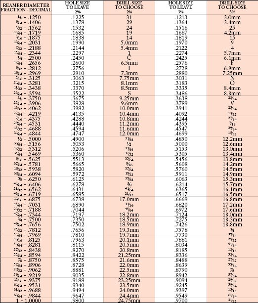

Ok so small update and more question. I got a hold of a box I made my parents with the same hinges. Near as I can tell, using a magnifying glass to line up the caliper tips, the pin diameter is 3/32". I am in luck there as I own a set of accusize reamers from 1/16" - 1/2" and it had 3/32". My question is what size do I drill the hole to before I ream? And does anyone have any advice for drilling a hole that small 3/4" deep in brass? I also measured the thickness of the hinge leafs (I think that's what they are called) and they are only 3/32" thick. It that enough for the vise jaws to grip or will I need some sort of creative work holding when I mill it down to the L shape? I forgot just how small these hinges actually are. We are ordering a pair off of ali as a backup in case I fail. But I am bound and determined to succeed. With all the wisdom on this site how can I not.

The pre-drill rule of thumb is 2-3% of finish (ream) diameter. Example 3/16 = 0.1875. 0.1875 * 0.98= 0.184"
0.98 corresponds to (1 - 2/100). 0.97 corresponds to (1- 3/100)
There are tables but a calculator works well for metric too LOL
Personally I ream with more like 5% without consequences, but its material & drill size dependent. Don't load the reamer with chips. Don't bottom out a reamer in a blind hole.
For example in brass or bronze, chances are you may be drilling with a dubbed tip in which case the hole can be a teeny bit larger anyway. Best to experiment on representative scrap
Brass is pretty forgiving for depth but peck drill, don't let the chips pack in the flutes. Small diameter drills don't usually have to dub the end.
303 SS I've had is ~ +0.003" oversize, but it can vary.
I'd probably drill about 0.005" under on that before ream. I wouldn't worry about over under reamers here. There's a time and place for that, but for a one off job, just take your pin in a drill chuck and with a narrow strip of emery cloth just polish the center section out where it will ride in the center section a bit. That'll give you enough clearance to hinge freely, while leaving the ends a nice fit in the fixed side. You can test it as you go to get the fit you want. Either use loctite, or my preference for this would be to slightly peen the ends over to set the pin in place, then file flat.
