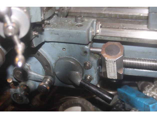

Found this on thingiverse
Since the Boxford is a Southbend clone, I assume the lead screw is 8 tpi. The gear is not shaped like a worm gear but has angled teeth just like my Southbend dial.
The angle of the teeth is the lead angle of the lead screw. It should mesh very well.
The worm gear looking ones have a larger area of engagement. A nice feature which cuts down on wear, but not a requirement for a threading dial as it only shows position of the lead screw and does not transmit any power.
