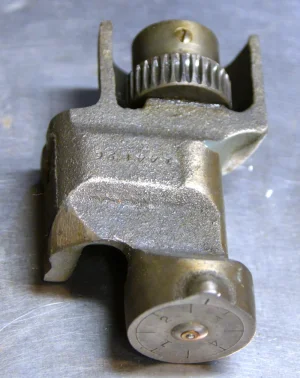

Gear for threading dial
The same on my little 11 by 36 Taiwanese. Leadscrew is 3/4 inch.
Ya, sorry about that. Kinda dumb to leave out the leadscrew diameter. Mine is 7/8"
So 7/8 - 8 with a 24 tooth gear on the thread dial that mates very nicely and firmly with the leade screw.
Also just for information: My South Bend has a 10 TPI lead screw (0.1" crest to crest) and the threading dial has 32 teeth. Since it tracks across the lead screw the pitch of the gear is also 0.1" between teeth which would make the outer circumference 3.2". There are 4 numbers on the dial with ticks half way between or 8 spaces.
Now if i disengage the half nut but engage the threading indicator I find that turning the lead screw through a distance of 3.2" turns the dial from line 1 to line 3. Of course with the half nut engaged it stays on line 1.

I like this. A threading dial carries no load whatsoever. It just sits there and goes for a ride. If one printed a nylon gear, it "might" last forever.
Ive seen some BB Threading dials on the left side of the carriage. I don't like that. This would make it possible to move it to the right side (where it belongs IMHO).

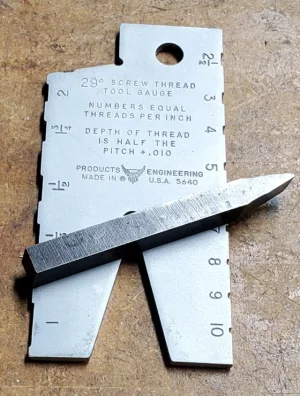

My thought was to use a bolt larger than 20mm and turn to size then make a hss threading tool to cut the threads. Then cut the flutes in the mill. The threads are likely metric buttress not acme so grinding a custom tool would be necessary
Edit-sorry not buttress but some metric acme like thread
Ahhhh. GREAT IDEA! I Like that WAY BETTER than just machining an existing bolt. And yes, you could use a hardeneable steel but why bother. Any kind of steel will cut nylon. I also totally agree with grinding a tool to make it an acme thread.
Mine is 22mm 8tpi but not a 60 degree thread
Are ANY leade screws 60 degree? I would think they would all be acme or similar.
Acme is 29 degree and Metric trapezoidal thread is 30 degree but looks like acme but of course acme does not have metric sizes so I don't know what to call it.

I started with the 1/2" ACME all thread. OD is 0.497" for the 10 TPI stuff. The one I made has an OD of 0.506" and in the plastic just cut that little bit deeper and smoother as the rolled ACME all thread has a ridge in the middle of the crest of the tooth.
It's not that hard to cut an ACME thread but the tool tip width has to be customized for the pitch. I used my 5C Collet Indexer to rotate the threaded part and a ball mill to cut the slot. IIRC. Not sure. Many years ago.
