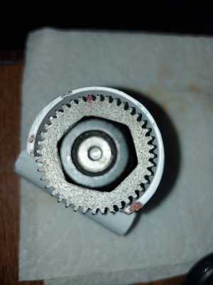

Hi:
A couple of us have noted that the gear in the threading dial on the Craftex CX-706 is a crappy fit to the related screw, as shown in the following:
There are gear design programs out there that ought to be able to draw a better mate and then print a 3D version. Right?? This seems like the perfect application for a 3-D printed gear--virtually zero power being transmitted and low usage.
I know just about nothing about gear design, though. Is this effectively a "worm gear"? The lead screw is 8 threads per inch. The existing gear has 40 teeth and is about 1.323" diameter.
Is there a web page that would walk a newbie like me through the process? Or maybe a kind member can whip something up?

I had the same problem with my CX701 when I bought it. Took a bit to convince BB that there was something wrong, then they sent me a new thread dial that fits.

Yes I'd say that is not the right profile gear to mate with the lead screw but it would work.
I think a gear like the one that came with my lathe is more correct.

I should mention that the existing gear in my threading dial is not a simple spur gear. It has a slight helix angle. It does follow the lead screw but it must be only the very tip of the gear tooth that is in contact. A couple of times when I manually moved the carriage back, the threading dial seemed to get shifted and lose contact with the screw. Which would wreak havoc if I was actually cutting threads!

I don't have a picture handy right now but could get one. The original thread dial had a 40 tooth gear. The one that fits properly has a 32 tooth gear if that helps Here is a picture of the gear that does not fit, it has 40 teeth. A way too fine.

i have never made a helical gear, but i have done several spur gears in fusion 360 then printed samples of before cutting on the mill, it was very simple
here is a quick video on how to make a helical gear in fusion 360
then it would be a matter of printing, nylon is the commonly recommended material for gears.....but its tricky to get to print, so be prepared, all metal hot end required

Thanks, but I really want a worm gear; not a helical. Ideally I think I want an 'hourglass' worm gear. May also be called a "Hindley worm".

Part #31 is described as a 17T Worm gear. It transmits power to the longitudinal or cross-feeds as selected. I think it probably needs the hourglass shape to bridge the 5 mm keyway in the lead screw.
I suspect that the thread dial needs a gear that has a multiple of 8 teeth (40? 32? 24?) but I haven't really worked through the ratios.
BTW, the ACME threads on the lead screw are not the typical profile of a worm combination. The profile for the thread dial ought to be much like part 31 above. Which just makes the whole thing more and more complicated.
I don't know if this has value here or not. The thread dial gear on my lathe has 24 teeth and my leade screw is 8tpi. If nothing else, it's a data point.
