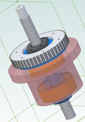

G3616 Conversion.

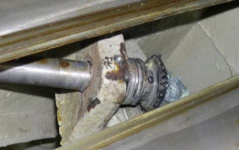

Oh and it won't be a permanent solution. The horizontal shaft turns a bevelled pulley which turns the lead screw.
I modified the original to have a bearing in a holder and tweak the mesh. Can't see it really well in this picture.
In the long run the ball screw upgrade will fix the ball screw shaft and turn the ball nut. The motor will sit vertically under the knee and drive the ball nut pulley. After that the backlash will only be the ball screw and I'll likely want to add some sort of brake to it to prevent it dropping when power is off.

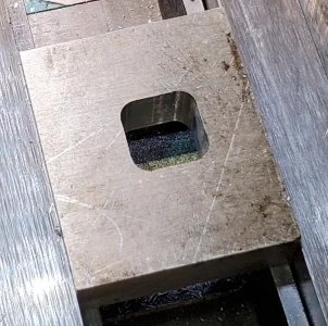

Using a 6mm end mill and 1mm depth of cut it shouldn't take too long. Probably longer to turn down the 2.25" blank to 25mm OD to fit inside the pulley. Then set it up on the rotary table so the square hole will be concentric with the outside.
The other approach is to first cut the square hole to make sure it fits correctly. Then mill a piece of steel to have the same size square shank to hold in the lathe and then turn the outside down.
If it’s any use, 14mm square socket is a very common dimension for butterfly valve shafts. The standard is ISO-5211 that most valve manufacturers adhere. It’s very common to use a large round keyed bushing into the valve gear operator, broached to 14mm square. If you can wait until next Wednesday, I can see if my old employer has a bushing on the shelf.
I make adapters all the time, always putting ABC-brand valves onto XYZ-brand actuators.
Thanks for the info. As always doing this stuff is a learning experience. For example I'm finding that it's likely backlash on the X is still not compensated quite right. At least at the position of the vise on the table. In the Y direction I get exactly 14.16mm as per the drawing. I'm 0.24mm short on the X axis which is about 0.009".
Also the 6mm tool bit is really to large. I'll compensate by placing a slight 6mm arc on each corner and make the X direction .24mm longer. It's a scrap piece of metal anyway.
The scariest part of doing all this is after the knee brings the tool setter up to touch the tool, measures it and then goes down, on goes the spindle and then at full 150 ipm over to the work. I've specified 10mm clearance which is more than enough but it's definitely butt clenching.
Just an air blast for cooling.
