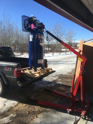

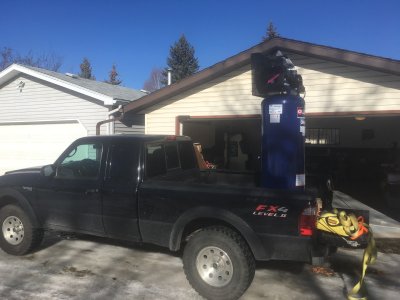

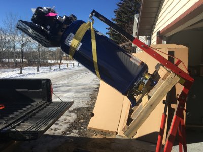

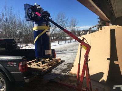

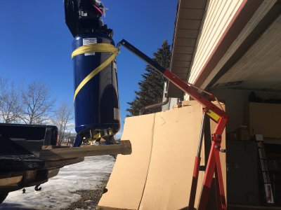

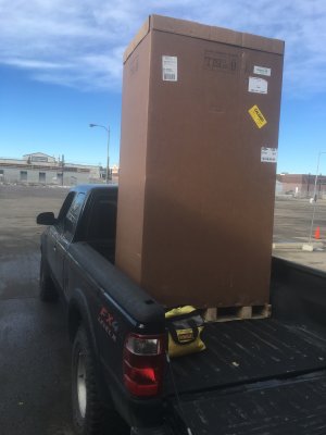

I finally got rid of that beast of a horizontal air compressor (~500lbs, cast iron, awful) I've had in my shop for two years now in favour of a vertical compressor.
Moving compressor home: (scary unloading this solo)
2016-02-13 11.52.53.jpg 2016-02-13 12.39.47.jpg 2016-02-13 13.06.05.jpg 2016-02-13 12.50.27.jpg 2016-02-13 13.19.04.jpg 2016-02-13 13.20.19.jpg
That last pump of the engine hoist when you know it's coming off the truck is terrifying, haha.

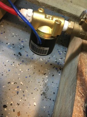

Next up was setting up a home-made auto tank drain. Really it's just a 12V actuated air solenoid valve:
Hooked to a timer. The line was been snaked through the shop out the garage door. The little bit of plastic tube sticking out of the garage may freeze solid in the winter, now sure yet, but will update when I know.

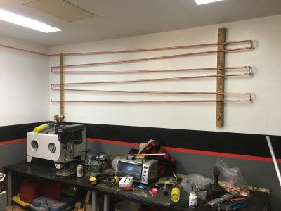

I have a little sandblaster, and want to get into paint, but historically moisture was always an issue, as I didn't have enough distance from the compressor for the water to condense out. As I want to plumb my garage anyways, I spent the tail end of my weekend getting started with plumbing copper lines into the shop.
First step though, was getting the water to drop out by cooling the air to room temp.
I plan to pull the wood down and paint to match the decor, but for now just wanted to get working on the piping.
I found several sources and did alot of math before finally settling on 1/2" copper, and the above design for cooling the air, while maintaining a heavy slope to gather the water at the bottom. (Not done yet).
The above is where I left off before bed, hopefully make some more progress tonight.
I plan to make one more u-turn with the pipe at the bottom, to a T fitting with a drip leg. From there distribute to 6-8 locations across the garage (one per side, one per corner).
I've also decided sweating/soldering copper is pretty fun. Will likely work with it in future too!
Will take some more pics as I go. :)
JW

Appreciate the concern!
I did a lot of research actually. Bursting pressure on this pipe far above max compressor psi. 850psi is the tube, the joints are the weakest point but still above air comp psi by a safe margin.
This cooling line style is not uncommon actually:
https://www.google.ca/search?q=copp...MzGMKHcIyDZQQ_AUIBygB&biw=414&bih=660#imgrc=_
And copper air plumbing is super common practice. :)
The benefits of copper are many fold.
Cheaper than black pipe at HD right now.
Lighter
Conducts heat better (cools)
Doesn't rust
Easy to put together,
Etc.
With regard to bursting, it's a lot of the reason I finally got rid of my old compressor, I did not trust it not to kill me one day.
Copper is deformable, which means if it were to leak, it wouldn't explode like PVC does, into shards. It simply develops a leak or crack, no explosion. :)
The typical reason that a cooling line like this one is put into a system is that the overall distance from the compressor to the gun is not more than 50ft, the recommended minimum for the compressed air to cool in line. This run simply adds the distance to drop out as much moisture as possible before the filters.

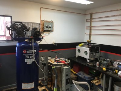

Worked some more on this yesterday. It's funny, you spend more time on a single access leg, rather than running 50 feet of straight pipe. The little corner shown below took forever to work through the kinks.
If anyone goes this route, buy way more fittings than you need. Grab a bunch of 45 degree fittings too. I keep running into sections where overlap needs me to work around the existing lines, or add spacing for the filters to fit, etc. 45's keep saving the day!
Two access points plumbed in with filters and regs now.
This corner bit took a lot of work, taking a line off the top, then feeding through the gaps shown. It actually feeds off the top line, then another pipe is added to the 45D angle here, feeding down towards the ground.

So @Jwest7788 - Josh - I read all this. Trying to digest. The long line allows the air to cool and water then condenses out of the air. I think then the water will fall to the bottom of your line to the ball valve at the lowest point. You extract the air above where the water gets trapped? And it's dryer? Do you actually get any water at the drain point?
Looking at the pictures more closely I don't think I follow. Is there some sort of circular air flow happening where the plumbing in the corner feeds dry air back into the top of the radiator section? Post more pictures with the final arrangement all in view? Thanks Josh this is interesting.

I'm actually finishing the project this weekend (hopefully) The top corner actually feeds behind the cooling line, down to an outlet, doesn't actually circulate back into the unit.
You've hit the nail on the head, water condenses out, drains to the lowest point, and is later removed from the system by opening the ball valve. Air (-liquid water) goes up the pipe and onwards to the rest of the system.
I initially had a small desiccant unit attached to the tool I was using, but liquid water blasted through the line and soaked the desiccant, which ruined it.
From there I learned, desiccant is meant to be used after the air has cooled, and water condensed out and separated from the air, to remove the last bit of moisture from the air, which refuses to condense, as room temperature is above the dew point of a little bit of water: https://upload.wikimedia.org/wikipedia/commons/thumb/9/91/Dewpoint.jpg/300px-Dewpoint.jpg
I'm not sure about the cat litter, that's news to me. Actual dessicant isn't too pricy at the store, considering it lasts for over a year if the above steps are taken. (or so I'm told)

More pics:
Each of the 5 outlets has a filter/separator and a regulator.
Another pic of the now complete corner shows the line going behind the cooler.
