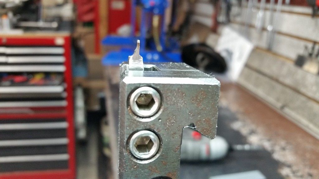

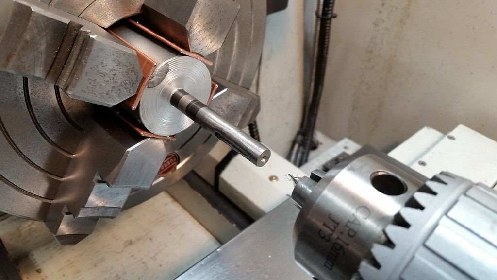

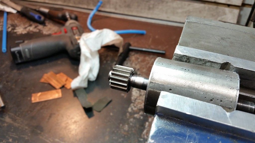

Andrew dropped off the armature, sun gear, snap ring and key for me yesterday. I got at the job this afternoon. First I had to grind a HSS tool to cut the snap ring groove. They are only .029" thick so I ground a 1/4" blank to .030" wide and have 1 degree rake on all the faces and tested it on a piece of cold rolled scrap and it cut well. I was happy as I've never ground a cutter this small before, it was a test for my eye sight.

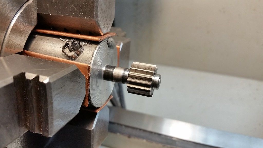

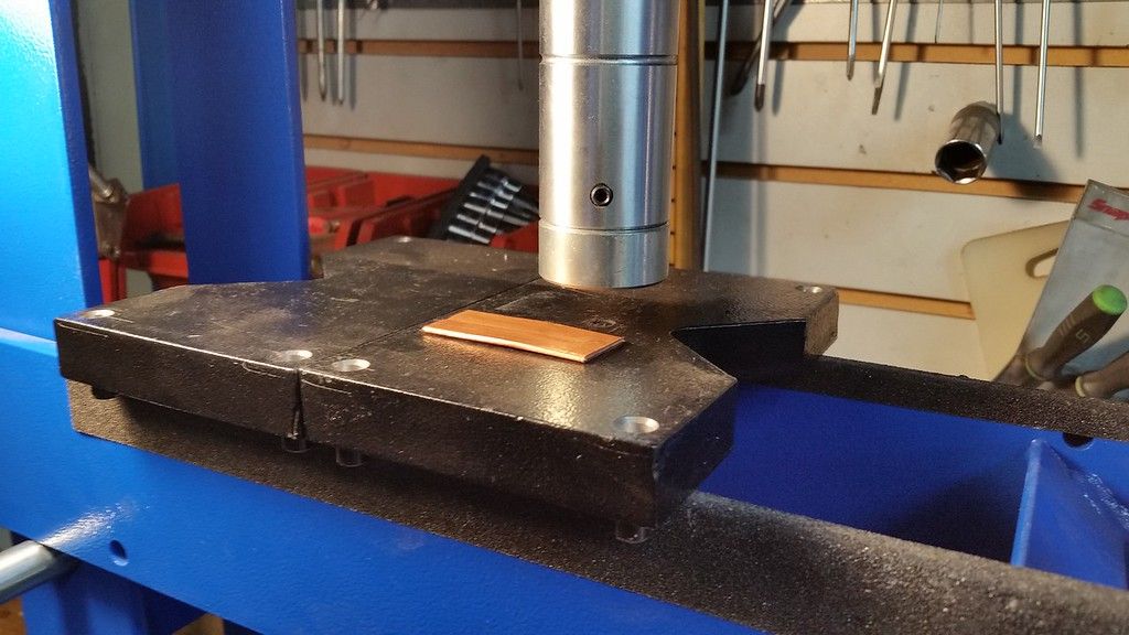

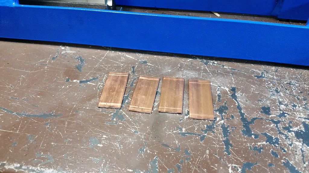

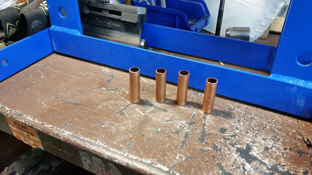

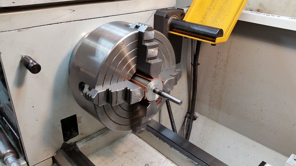

I wanted to mount it in a 4 jaw so I made some copper shims from 1/2" pipe to prevent marring the shaft.

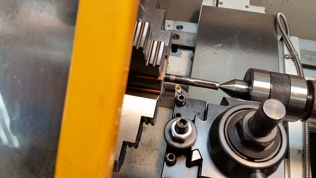

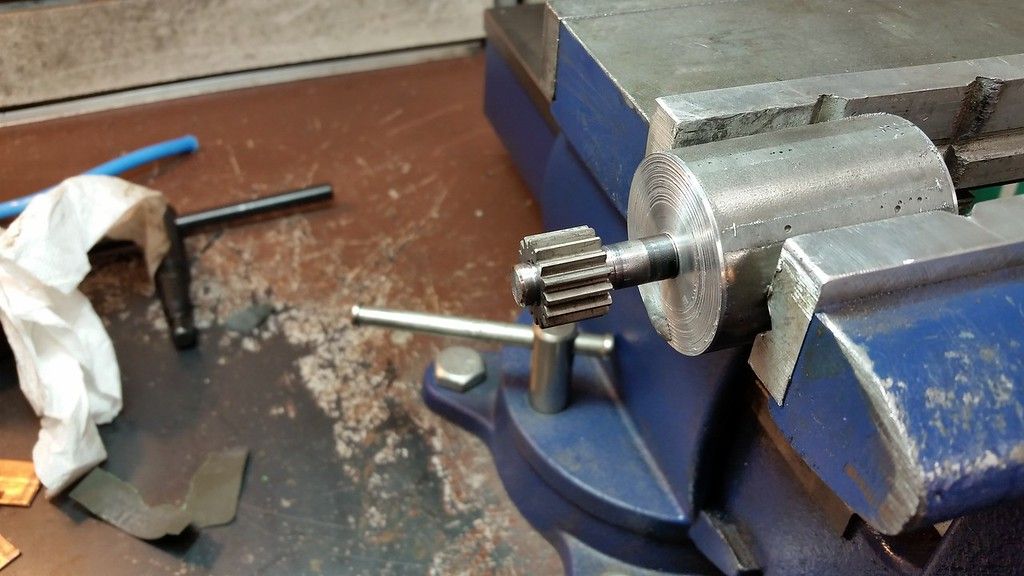

The original shaft OD was .375 and the ID of the new gear is .355 so there was not much to take off. My goal was a hand push interference fit and it took quite a while to get that, the last .0003" removed with 400 grit sand paper. the groove cutter worked flawlessly and I cut the 2 grooves to .045" smaller OD than the shaft OD.

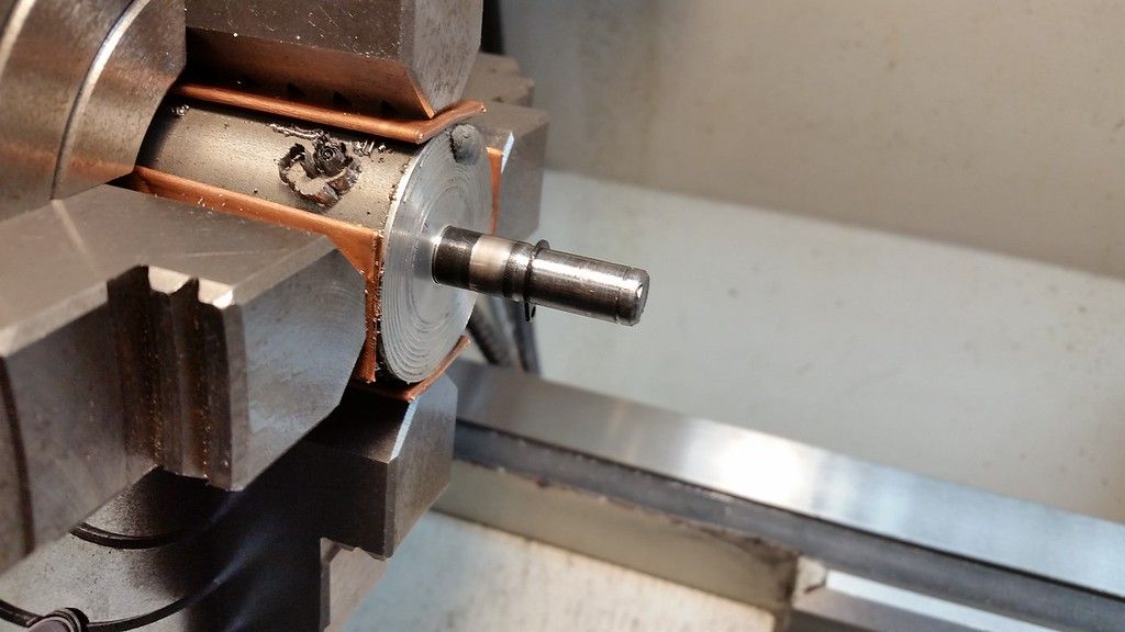

I parted the shaft off at the end of the original key slot.

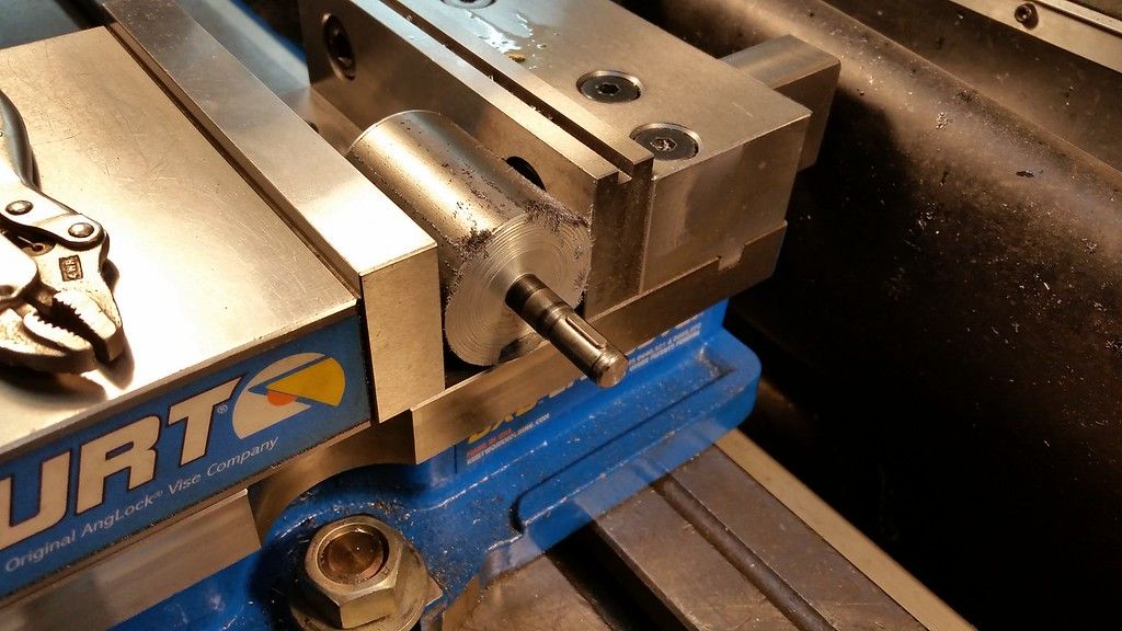

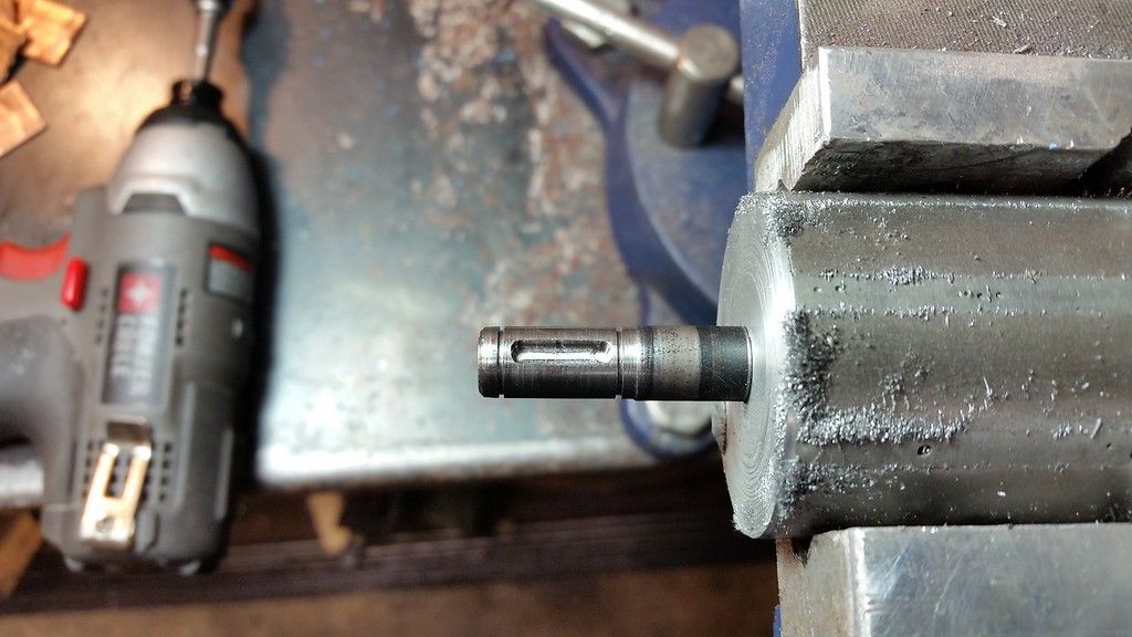

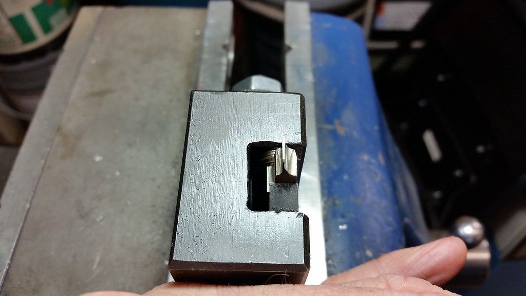

Then over to the mill where I used 3/32" end mill to cut the 3mm key slot.
The magnets are so strong that you almost don't have to clamp it in the vise, it just sticks there.

Turned out nicely!
Tip:
Being a very strong magnet I was initially a bit worried about how I would clean the shavings and dust off the unit. Duct tape saved the day once again!
