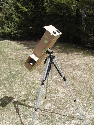

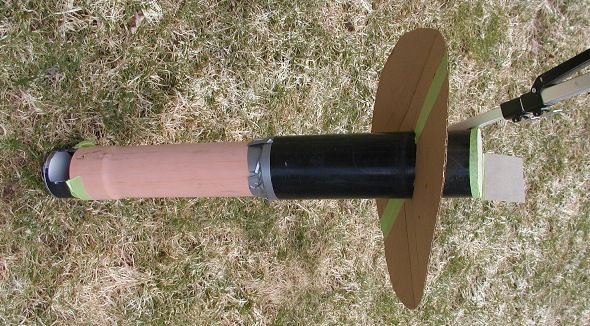

Our rigs: On the right using a pair of binoculars to project an image on a back plane, on the left leaning on the chair, a tube with a 1.25 diopter lens projecting on the view plane and in the middle of it all Kira guarding the rear flank. The folks behind sounded like they were from South America.
I built a couple of rigs because I didn't know what would work and since the weekend was cloudy I couldn't test.

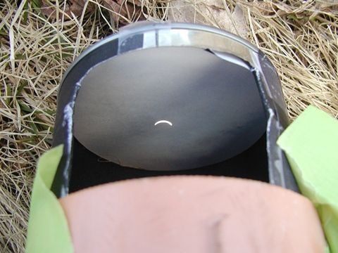

The lens in a tube gives an image like this:
We had a bit of a breeze going so it gave a more stable image than the tripod/binocular viewer.

In case anyone is interested in the rigs for next time in Spain/Portugal......
The binocular rig is pretty simple, basically hard mounted to a board with a projection screen of card stock inside a (mostly) light proof box. It's on topic for the forum because I used the mill to make the tripod adapter and binocular mount.
It's hard to see but there's an aiming pointer on the front plane that projects a shadow on the front of the trap door.

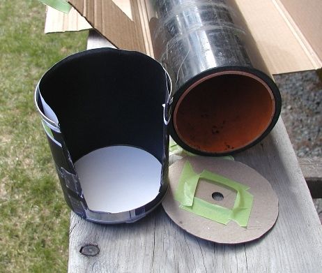

The tube viewer is pretty basic, some DWV and some gas tubing with a 1.25 diopter lens from a pair of Wallyworld reading glasses behind a 1/2" hole in the front plane and projecting on the back plane. Easy to make at the last minute with things on hand and I was really pleased with the image, much better than the recommended pinhole camera. Focus is adjusted by sliding the tubes in /out, the cardboard is a shade. We leaned it up against a chair for aiming!
The parts - pretty basic: tubing, cardboard, paper, a tin can and a lens! I was lucky to have all the bits on hand.
