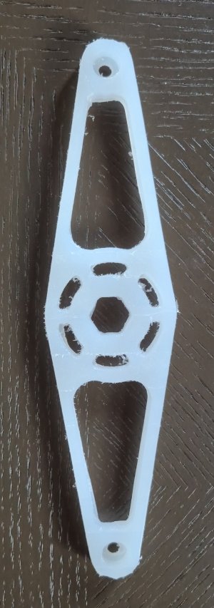

Well I finally got it all working and completed my first part (see below, speed handle for my mini mill). It's a little rough but ok for a prototype made from a cutting board without the use of the probe or puck. Slight little issue but sorted out now.
To say I learned a lot from this experience would be a massive understatement. I've been learning through this process for months, so here's my thoughts:
Journey & Machine after thoughts:
No initial instructions in the 5 x boxes (link for download provided later) and no parts list (really needed when there are this many parts and some are missing)
1. Mechanical = 98% (only a couple of undersized holes but nothing a larger drill bit couldn't fix).
2. Electrical Install = 75% (The kit was missing a lot of the required wiring).
3. Electrical run up = 50% (this kit came with an upgraded DMC breakout board and upgraded motors, both of which provided more issues than anyone should have to deal with). Eventually it got sorted out with trying different connections and adding a grounding wire between the Mach3 board and the bed.
4. Mach3 install and runup = 80% (A bit of a learning curve for me as this is my first CNC, but after all, it's just software and it definitely has it's own personality. I choose to use it as the machine is setup for it). Note, I got the probe and puck all working fine and left it until the next day to run the first part. When i checked the probe the next day, it was all F%^&*($ up. I changed the screen a couple of times and it sorted itself out, so I believe Mach3 is very electrical field sensitive.
5. Support = 999% ( I would say 1000% but being on the west coast, it takes about a week to get parts). Otherwise it was fantastic. I always received answers withing a day or so with most of the details and fixes I needed. Sometimes I managed to figure it out before they got back to me, but in the end i have no complaints.
