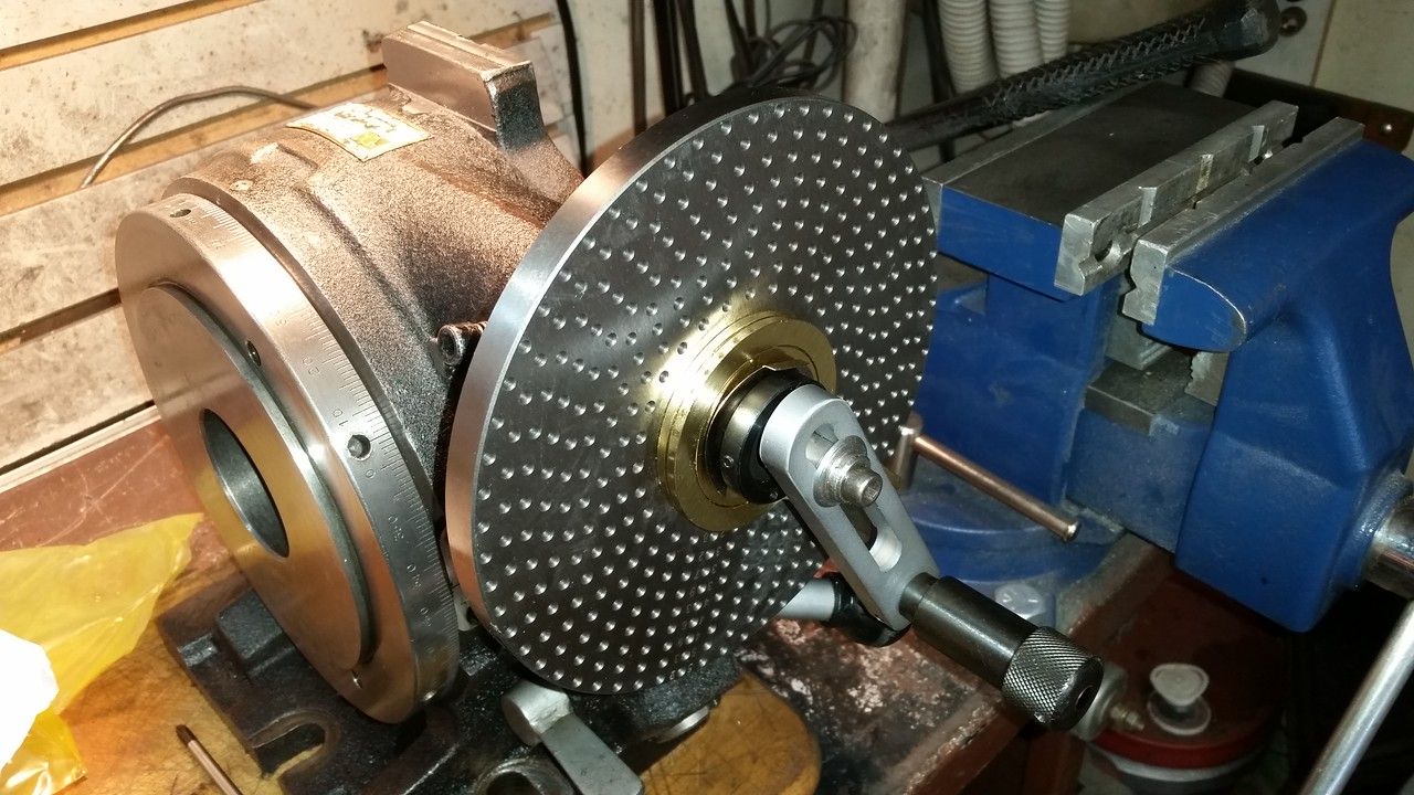

Dividing head restoration

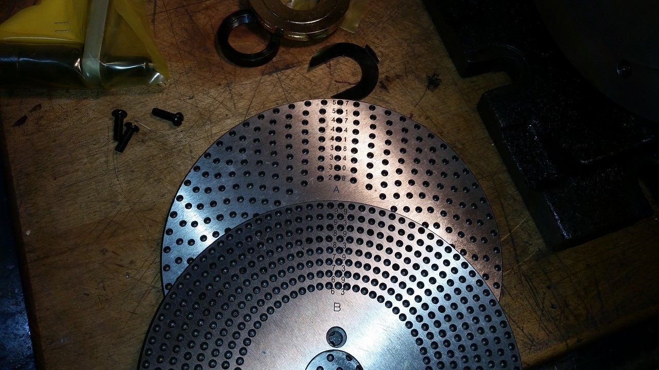

That indexing plate looks pretty similar to the ones for my Vertex super spacer. Since the import tools are almost always direct copies of older North American or European stuff they may fit. I have 2 plates each with 2 sides. The center hole is 1.130" diameter and the OD is 7.085" the 3 screw holes are on a 41mm (1.616") bolt circle . They are .475" thick.

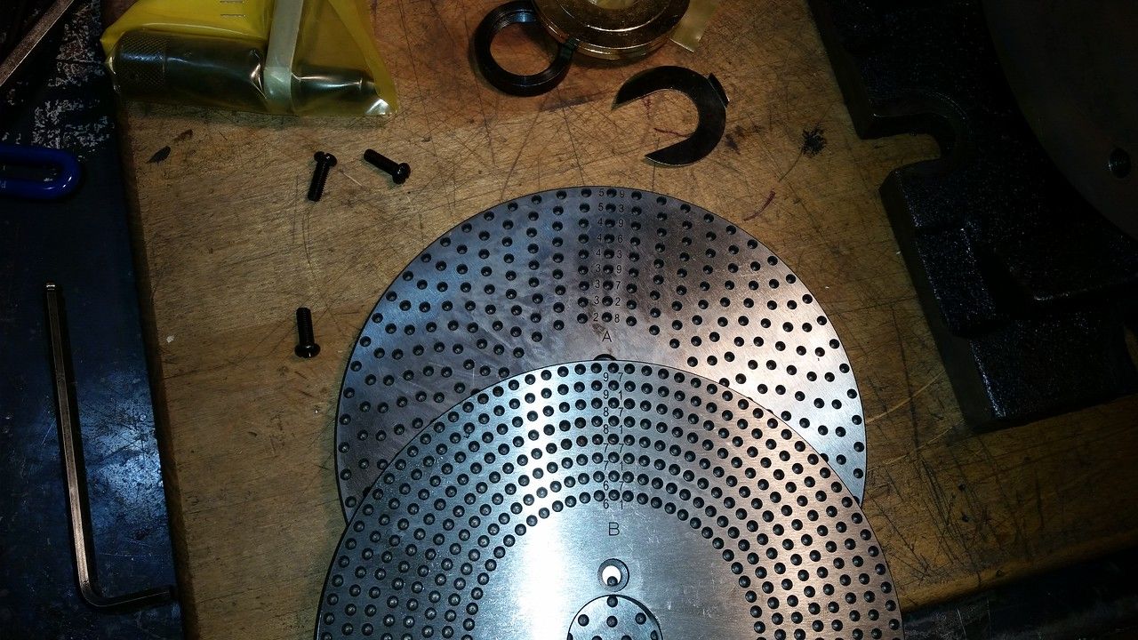

Mine has significant differences. Mine is one sided, center hole is1.175", the OD is 6.8125", screw holes are 0.25" and plate is 0.325" thick.
So after thinking about it a little I started to wonder if my response should have been is it easier to adapt plates even if dimensions are not exactly the same or easier to make my own? Also what number of holes or divisions would be needed to cut spur gears assuming the 40:1 standard ratio?

I'm impressed with the look of that machine ...can bet it has a much more complicated inner working mechanism than a simple worm gear angle drive like the import Vertecs a lot of us have.
