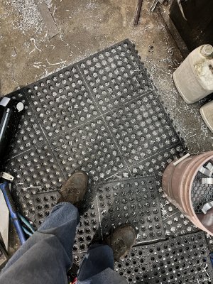

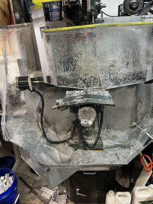

I use a simple 12vdc sump pump (about $25.00 from PA). I use Ionic coolant which makes clean up a lot easier. If you plan on doing this be prepared, even with all my splash control in place flood cooling makes a mess in the shop as it does get out.
What I like is that the tooling stays cool and sharp even when pushed.
This is the fundamental question I wonder about before trying out the coolant pump in my mill (First BP clone). How bad is it? Are we talking thin film in a 3' radius of the machine? Slippery? Is it easy to clean up? Do I invest in more shields/covers?
I use Microchip from KBC, basically it helps the water cool.
Floor slipper No, Potentional splash radius depends on how fast and big your bits are. I'm running a 1/2 4 Flute Carbide end mill at about 3500rpm (should be 3000rpm but something to address later) Running at full bit cuts 0.050" deep at 20ipm.
When I did this without splash guards 4-6ft.

I have to say I added flood cooling well before CNC as the finish greatly improves, not to mention extended bit life (even with HSS at that time) even for short small runs as it allowed me to use 2 hands (axises) to do custom stuff.
While cutting oils are great, they create smoke and have other nasty issues to consider with use. Flood cooling with Ionic coolents have none of these issues, just remember these are about cooling and flushing, not lubrication like oils do. Each have advantages and disadvantages.
