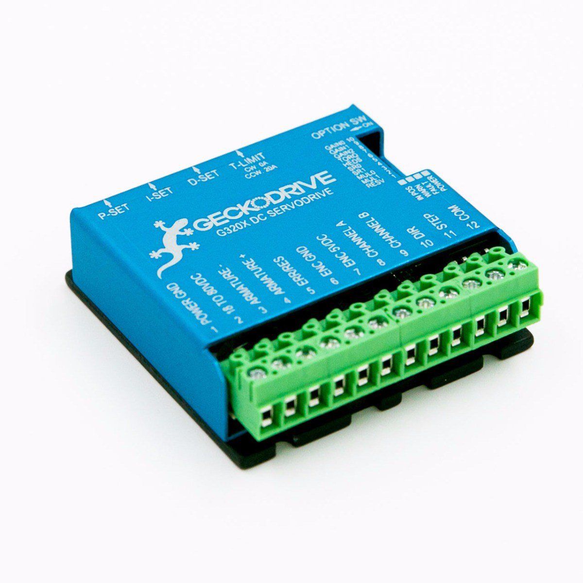

Finally I also have two of the GECKO G320 servo drives (unused).
However they all have the same disadvantage as would a stepper driver (I have two from Bergerda) in that setting the current dynamically is not possible. A Bergerda AC Servo drive (or any of the other Chinese brands) usually have MODBUS but that then requires a separate serial connection to set current and therefore torque.
With the UHU series I could wire a small dip relay onto the motor direction pin to parallel a second resistor in the current set circuit. So on tightening the relay is open and current set is through a single resistor. On loosening the relay is closed and a second resistor in parallel with the first to increase current and therefore torque. (Edit: I could do that with the GECKO too).

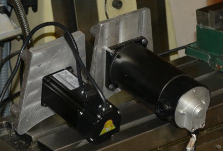

All the newer servo drives are like that now. And size for the servos is way smaller with AC servos really being small compared to brushed type. These two have the same torque/RPM specs.
3000 RPM, 1.27 NM. (180 oz-in) 3.8 NM peak (540 oz-in).
For my heavier Y axis with the 4:1 that gives me 720 oz-in at 750 RPM way above what any stepper can do. On the X axis I have 3:1 so 540 oz-in all the way up to 1000 RPM. Looking at the current meter on the AC Servo drive display I'm not close to the max continuous current much less surge.
And quiet.
But since I have a couple of those smaller 24V brushed motors rated at 2.7A and 3000 RPM and the drives I might as well use them.
