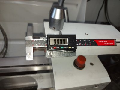

Working on the TouchDRO.
This is for my lathe which is two axis only obviously. I chose to mount the two 'spare' DB-9 connectors but not make the connections to the board. That's why the connectors are 'loose like that. They are zip tied together so they aren't completely loose inside the enclosure.
Why is that obvious David? I confess that I am considering the pros and cons of putting scales on my compound and tailstock too. That's 4 altogether.
The advantage of a tailstock dro are many.
But one on the compound could be used to determine and/or set angles, develop resultant combined movements, etc etc.

I’m talking about axis not number of scales.
A mill is three; X, Y and Z
A lathe is only Z and X.
If you have a milling attachment there would be a Y but that's the exception.
A tailstock is Z
A compound could be X or Z or some combination thereof.
