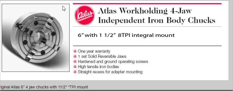

Same question about the Atlas 4-jaw. Does anyone happen to know if the backplate can be removed/replaced like Bison 3J?
@PeterT - here's the link to the original thread on these chucks.
