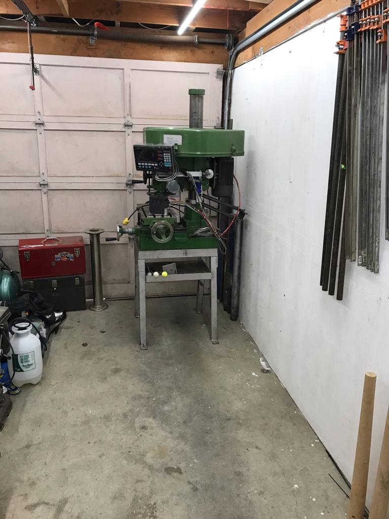

After working in my reconfigured shop I came to the conclusion that the configuration that worked on paper, didn’t work in reality.
So I spent the day moving the mill and lathe, swapping them into the spots previously occupied by my tablesaw and other woodworking machines.
Now I can easily access my saw which was previously a real bear to use.
The saw used to live along this wall and I would swing it out to use it. Problem was that I couldn’t get by the thing. Plus I had no way to use the dust collector so it made a hellacious mess.
So now the mill and lathe are on this wall.
I have several machines that weigh 3500# each so not interested in moving them once in position. I used my Autocad program to make a scale drawing of the shop and each machine. Mills were drawn with table at the 4 extreme positions. With space at a premium, when running a lathe and turning around there needed to be another machine or work table there. Lots to think about with each machine — lathe needs lots of room to the left of the headstock and enough room on the right to remove the tailstock. Mills need room off both ends of the table. A tool&cutter grinder needs operational access from front and both sides. V. bandsaw needs room to the right and H. bandsaw needs room both sides of the blade. I put a lot of thought into making this extra operational space useable for other operational space as well. I was very pleased at how well the plans worked out….. until I bought a 16” shaper. Back to Autocad.
